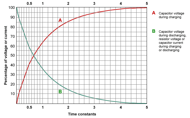

You are definitely on the right track now. Just one small detail we have to clear up.
In the line:
"10v * (1-e^(-1/10Ω * 2F)) = 1.81269246922 volts..?"
it is clear that when you or your calculator calculated the part "-1/10Ω * 2F" you or it multiplied -1/10 by 2, which gave you or it -2/10, which is correct for that writing, but is not correct for the formula that has -t/RC in it because the implication is that R*C is to be performed first. That is partly my fault for writing it that way as the better way is:
-t/(R*C)
where it is more clear that we have to multiply R*C first.
So looking at the entire formula again:
Vc=Vs*(1-e^(-t/(R*C)))
and since R*C has to be done first we can do that right away, and with R=10 and C=2 this turns into:
Vc=Vs*(1-e^(-t/20))
You could try that again and see what you get, as well as the second example you gave.

Hi,
Well you got the right answer previously so why would it be different this time? Maybe you where not sure.
In this try, the 1-e^(-1/20) did not come out right.
For charging we had:
and for discharging it's even easier:
Vc1=Vc0*(e^(-t/(R*C)))
Note there is no '1' in the formula. Also, Vc0 is the starting voltage of the cap before it starts to discharge. Vc1 is the ending voltage after the time t.
An example would be where we have a cap that is charged up to 5v and we want to know what it discharges to in 1 second. For that we would have so far:
Vc1=5*(e^(-1/(R*C)))
and then just plug in R and C and compute the whole thing.
Yes it will be slow when the cap value and/or resistor value is large. In fact, when the product R*C is large it will be a slow response. Keep in mind that the values of C that we often encounter is maybe 0.1uf or 1uf. We are working with large caps when we say the values of C is 1 Farad. That's good enough for the practice examples however.

Ok, a quick and dirty answer to your question is
Capacitance in Farads multiplied by resistance = time constant.
About 5 time constants will be enough to discharge 99% of the voltage.
A 1 M resistor and a 1uF capacitor
1,000,000 X 0.000001 = 1 second "time constant"
It will discharge to 1% of initial voltage in 5 seconds.
wayneh
Joined Sep 9, 2010
18,124
There's a very good reason to use the approach @GopherT just noted. Once you know how one exponential curve looks in units of the RC time constants, you know them all. Every RC curve looks identical when the percentage is plotted against time expressed in multiples of RC. Decay curves fall from 100% and approach 0%. Charge curves are just 100% minus a decay, so they start at zero and approach 100%. They're all the same.
Even simpler, you can remember a single number. Each increment of RC leaves 37% (0.37 = 1/e) of whatever you had to start with. So the curve is (0.37)^n where n is the number of time constants that have elapsed. Note the handy result at 3 time constants – 5% remaining. Or the one GopherT used, ~99% decay after 5 time constants.
time, in RC
0 100%
1 37%
2 14%
3 5.0%
4 1.8%
5 0.67%
But I still suggest you get more proficient with your units and concepts before you start using shortcuts.
