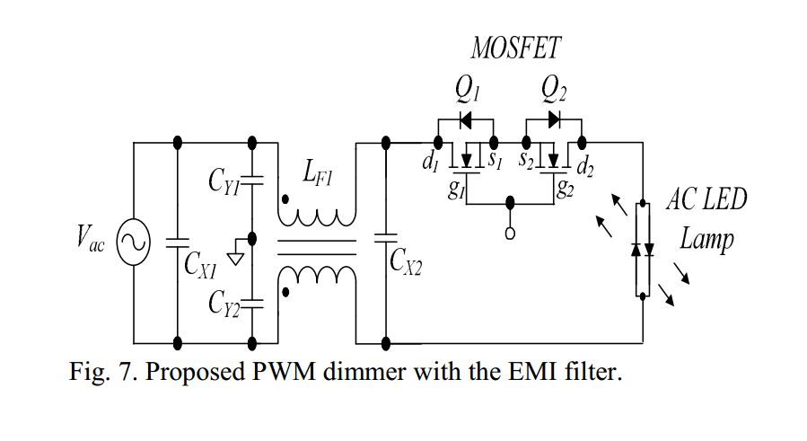

After many cycles of errors and smoking components, i am finally at the stage in my project where i am ready to design a filter to convert my chopped AC waveform into a smooth variable amplitude sinusoid.
I was wondering if anybody had knowledge of any good places to educate ones self on this application.
( i apologize for my apparently lazy question, I have looked but have come across nothing too helpful)
I am dimming a bulb using PWM at 25 Khz and intend to filter this to eliminate some EMI problems stemming from switching 10+ amps at 25Khz.

i also just realised i created a thread about this a few weeks back that i totally forgot about.
I downloaded and played around with the filter design tool mentioned in my other thread, though i am a bit overwhelmed by the volume of input parameters.
The image above is the first result i got from the filter design tool.
The result is attached and seems to filter out the PWM effectively, though i genuinly have not much of a clue when it comes to this field.
When you suggest an EMI line filter, is that to reduce EMI going back to the lines or is that for filtering the PWMed waveform?

I think that switching high currents at 25Khz could be quite problematic with regards to EMI.
I am using a configuration very similat to that pictured above - but my load is of much higher power than the LED's

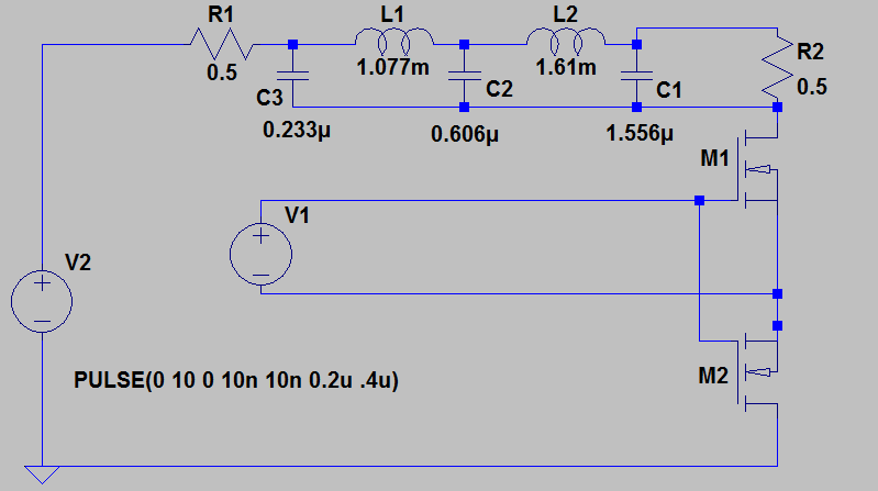

I have been playing around and managed to get a filter that appears to work, however its feasibility in the real world is where i am unsure.
The circuit shows i am using a capacitor and inductor with my load (bulb).
The waveform shows that the load waveform is clearly filtered and a nice enough sinusoid.
However, the supply and capacitor currents appear to be alarmingly high pulses of up to 260A.
What should i make of this?
EDIT: this arrangement seems to not work, altering the duty of my PWM does not vary the amplitude of the sinusoid as i thought it would.
