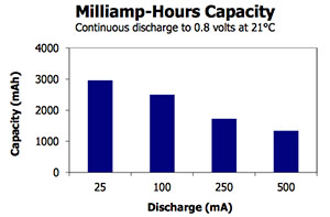

I do have a healthy respect for batteries and particularly those contain Li. Not posting on that issue, but instead on the OP's title question. As a result of reading some of the responses here, I did some reading in http://data.energizer.com/pdfs/lithiuml91l92_appman.pdf which is for the batteries I mentioned in post #6. I did not know and was pleasantly surprised to learn that there is, essentially, a resettable thermal switch in these batteries to prevent excessive current draw (I mean the PTC not the vent hole).
From p14.
These two safety devices are a resettable thermal switch or PTC (Positive Thermal Coefficient) and a pressure relief vent. The PTC protects against electrical abuse scenarios by limiting the current when the PTC temperature exceeds 85°C. As the battery heats during abuse, the resistance of the PTC rapidly increases and significantly limits the amount of current flowing through the battery, thus allowing the battery to cool. When the PTC cools to below the activation temperature, its resistance returns to a normal level allowing normal battery use.

More to the point is , just what sort of useful output can you get at high currents .. Of course when truly shorted all the output goes to heat the cell , but at about 5A around half the total output is usable ... Energizer only give AHr capacity at low currents , but the trajectory is sharply down, at 5A you can perhaps only expect a tenth of the capacity you get at 25mA.... not the case with lithium cells .
