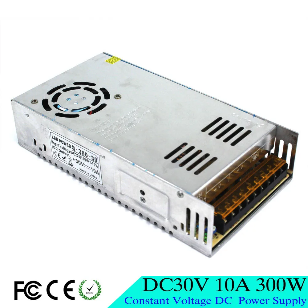

Ok I found out how to make a 5a power unit like R!F was talking about,
and I got all the materials In my house from another project. (looks real professional too) But it is limited to 30v at 6A and it has only a course adjustments.
1. how do I make the fine tune gain that I need. the video shows a course gain (as I under stand it)
2. my concern on the low voltage side is that the unit might not be fine enough, any way to make sure that the unit could get accurate voltage at low amps?
3. below is the table for the different Nichrome wires I will be using) I need voltages range from.8 to 71.5 volts and from 1 to 5.61 Amps, So how do I get the higher voltages needed? can I simply create a transformer, with a metal rod (say 10 wraps of wire on one side and 20 on the other) to drop the amps and double the voltage?
I was thinking of adding a high low switch on the Ltc3780 buck up/down converter that would allow me to take the voltage from lct 3780 and send it to this unit http://www.ebay.com/itm/600W-DC-DC-...722860?hash=item1a257743ec:g:IIAAAOSwX9FZJ~8V
This would allow me (I believe to take 30vdc and bump it up to the 71.5v @1.32a I would need safely.) then just flip the switch to low position to use the 0-30v. would this work?
