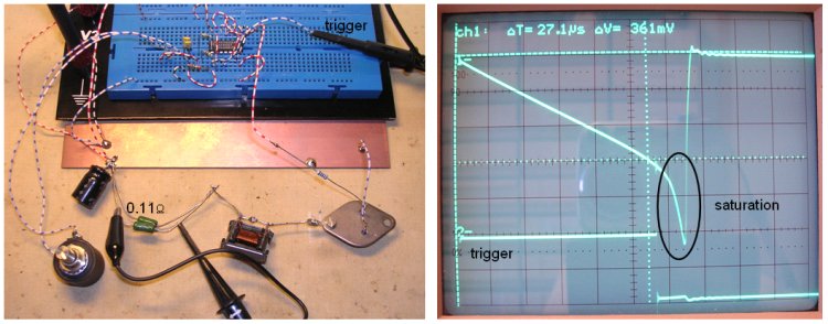

Hi guys,
I'm back. I am satisfied that the HCPL-3180 Avago optocoupler works as well as the IR2117 gate driver. In fact, I could have a pulse with peak amplitude of only 3.3V to the photodiode by tweaking the optocoupler series resistor. And I just love the optocoupler because it does not need any Vcc (IR2117 does), but only a bootstrap configuration.
Attached are my circuit connections (still using breadboard though for testing). Also, I've used a 10V z-diode to clamp V(gs).
Ok, here comes my next challenge as well as a little problem. In my past various testings, I've used a stand-alone low voltage DC PSU (10V) to provide the necessary source to charge up my bootstrap capacitor periodically. I would now like to remove that, and instead utilise power from the HV 100V DC rail.
As necessary, I've first done my research about auxiliary power supply and now that I share to hope to get more insights from members with good experience over here:
100kΩ resistor in series with 10V z-diode:
As seen in zener_setup.jpg, R=100kΩ in series with a zener of V(bk-dn) of 10V, therefore V(R)=100-10=90V. I(z)=V(R)/R=90/100k=0.9mA.
I've constructed the schematic on a breadboard as shown in zener_breadboard.jpg. I've chosen R = 120kΩ and z-diode 1watt 1N4740AC.
The 100V DC supply is then connected to the top part of the 120kΩ resistor and the zener reverse voltage is being recorded by an oscilloscope as shown in zener_oscope.jpg, with a reading of ~9.886V.
Here comes my question, if I connect this regulated 10V to my optocoupler as a replacement for the LV DC PSU, would the circuit readings change? What I believe is that this optocoupler would draw some average current, and hence in turn, changing the current flowing through the 120k resistor, that is, I(R)=I(z)+I(optocoupler). So to find out how much current will the optocoupler draw, I've measured with the original setup (the one with LV PSU to supply the bootstrap cap charge), the avg. current is about 7.10mA (see Optocoupler_Iin.jpg).
So will this work as a substitute for a separate LV PSU for charging the bootstrap cap?
Thanks in advance.

I can hardly believe that you got ANYTHING to work on that breadboard, particularly how you wired it. There are big loops of wire running everywhere!!
Breadboards are fine for low-frequency analog stuff. When you start getting into the higher speeds, the parasitics kick in and ruin your day.
You need to use the "dead bug" technique, or use stripboard, or something similar - like making a custom board.
I don't know why you are trying to use an auxiliary supply rather than the boost diode and boost cap. The boost cap and diode are very efficient. Your 120k resistor and Zener will dissipate ~80mW power, so you'd need at least a 1/8 Watt resistor - 1/4 Watt would be better. Don't forget, you're going to need a bit extra current for the Zener, and you'll still need a decent-sized cap there. If the supply cap charge decreases too much, you'll start running the MOSFET in the resistive mode and burning them up.
Thanks SgtWookie for your reply, after this "last" implementation, I would wired the circuit onto a stripboard which I've made as shown in stripboard_structure.jpg.
I apologize for not being clear in my previous post, I still really do want to continue to utilise the bootstrap config but instead of using a separate unit, a LV 30V(max) DC PSU to supply the bootstrap charge momentary, I would now like to obtain the charge or current from the 100V High DC rail. By doing this, I could simulate a more realistic situation because, ultimately at the end of the day, there would be only a 100V DC battery supplying power to all the sub-system, including the boostrap supply.
So in order to tap the votage from the 100V HV DC rail, I suggest the traditional zener (voltage regulator) method. Although many has said this method is usually inefficient, a 80mW power dissipation may be considerably low for a 100W supply unit, however, I would still consider any other methods which are better in efficiency.
I know it is a hard decision since it is not easy to trade off efficiency with complexity, afterall, I am willing to sacrifice a little more efficiency for simplicity.
I've in fact used LT Spice to simulate the z-diode voltage regulation method as an intended replacement for the LV DC PSU. What I could not understand is when I connect a pulsating current source to simulate the bootstrap drawing current periodically, the voltage at the zener's cathode could not maintain at 10V which I orginally believed it would be.
Is there some other components I would need to add or in fact this method won't work for my application at all?

10v isn't going to work. You need to read the datasheet and figure out what is the minimum voltage you need on the boost cap in order to get it to work properly, and stay a couple of volts above that.
As far as the bootstrap drawing current periodically and the voltage at the Zener's cathode not maintaining 10v; I've basically told you how to fix that before.
You need to think how to interface the current supply at the Zener to the charge requirement of the boost cap. I'm giving you some very big hints here. I can't do the whole thing for you, or you won't learn anything.

Here, I'm just showing the part about inductor saturation in the attached simulation.
S1 doesn't have much effect in comparison to when S2 kicks in. When saturation occurs, current skyrockets.
Compare that to the plot of a real inductor going into saturation on this page:
http://dos4ever.com/flyback/flyback.html#ind2
Ronald Dekker has created a great resource for hobbyists, students and even professionals that might've forgotten or never known the basics on making your own inductors and testing them.
This is the image I'm referring to:
A real inductor at saturation.
The inductors in LTSpice are ideal; as if they were air core inductors; air core inductors don't saturate, but it takes a heck of a lot more wire to get the same inductance.
Hope this helps you understand what's going on more.
