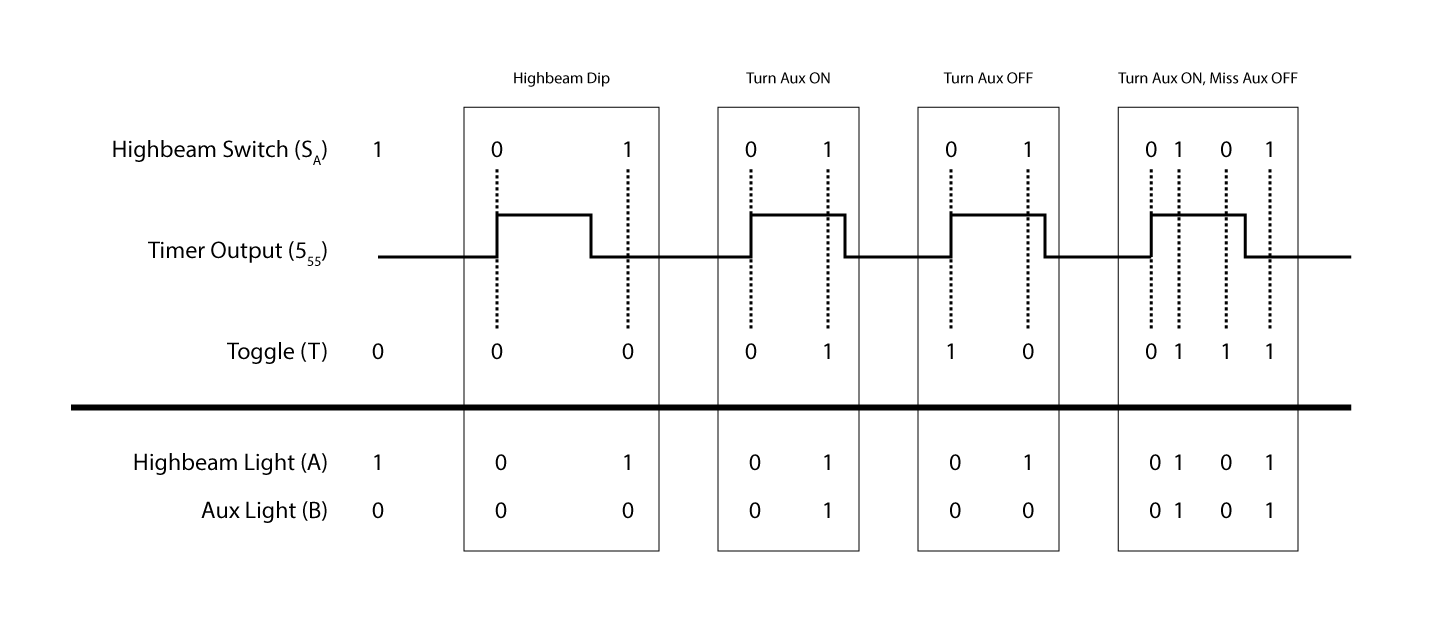

Thanks for checking in on my posts. This is great practice for me. It has been a long time since I did a "discrete" state machine. For the last couple of decades, they have all been buried in programmable logic and designed with a high level language. So, my contribution is selfish, in a way.
It is entirely appropriate to be thinking about components. A couple of thoughts. 1) The delay is more accurately a "one shot" function. It may or may not want to be "re-triggerable". This means when the switch goes off, the "one shot" fires again even if it has not finished from the previous trigger and stretches the output time. This is a detail to be faced at some time. See
https://electronics.stackexchange.c...a-nonretriggerable-and-retriggerable-one-shot
2) If not going with mechanical relays for a "vintage" design to match a vintage cycle, check out "solid state relays" as the switches which connect the lights to the battery power. Modern, simple and reliable.
The bike is a late model Kawasaki KLR 650 — old technology but not qualifying as vintage. I doubt there is code or equivalent involved, for example, in the ignition module but surely there is a custom IC or two. The beast has no "input" plug for diagnostics or anything like that. It's carbureted, so no brain in the fuel system either. And aside from a few updates to suspension and fairings, the bike the same from the mid-90s until 2018 (the last model year… rumor has it they're bringing it back next year or so, probably in contradiction with the above). I like the idea of the solid state relays; would these be MOSFETs or something similar?
When I was making the truth table, this isue of "retrigger" occurred to me as well. The condition would be one of "missing" the second toggle signal, like the rightmost box in this diagram:
I was thinking this would be solved by making the timer output go low when the highbeam switch (S.A) is turned ON. My thinking was that this would allow the timer to be retriggered when S.A is turned OFF again… The change to the above timeline would be that 5.55's pulse ends whenever S.A is turned ON. However, this would invalidate the logic for using the AND between S.A and 5.55 to drive the toggle , So that's a no-go.
I haven't read your link about the one-shot because I'm wiped out tonight, but I'll dig in tomorrow. I'm sure we can resolve this dilemma. From a purely functional point of view, I can see where this is not that big of a deal — it's something I could work around ergonomically. From a "quality work" point of view, though. it's definitely got to be resolved ;)

Your timing diagram is excellent. Very often, a timing diagram is produced first and the state diagram falls out from it. It is the best way to communicate the requirements. One suggestion is to expand it (horizontally) and include every possible sequence you can think of. For example, add the high beam going off. In my state diagram, the high beam (output A) does not go off when the switch is pressed ("flicker"). But then, it does not go off until the one shot is done. Up to you....

Here's the expanded version of the diagram, also with the states I identified in the truth table called out again. I did this last bit of effort mainly as a means of cross-checking my work so far before setting in on the state machine diagram (it checked out). Note that red is used differently here than in the state table. Here it shows the "miss."

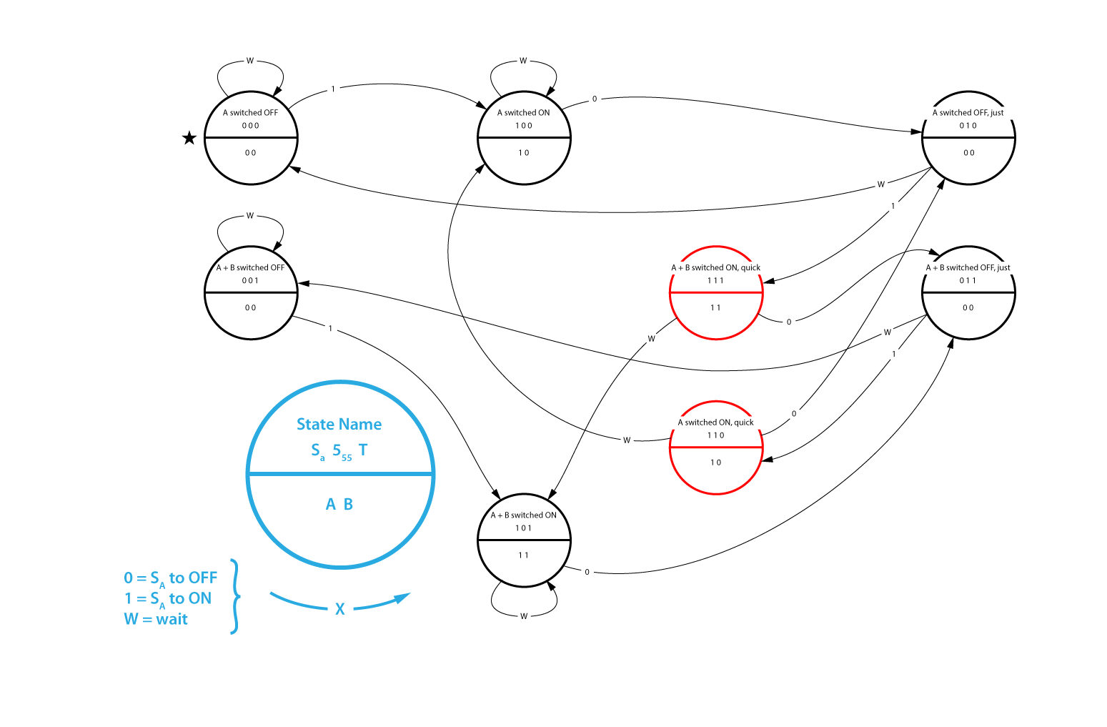

And here is the promised state machine diagram. Please look this over and feel free to make suggestions and/or corrections. Red is again used to identify the "toggle" states, the same as it is used in the state tables.

Now that I put this diagram together, I'm comparing it to yours and I have some questions. I'm not sure I did mine correctly.
The procedure described in the article is quite a bit different from what I've done, and it's probably more similar to yours. I'd like to get on the same page, functionality-wise, and then update my diagram as necessary.
You mention before that you were thinking the main light (highbeam) would not turn off immediately with the switch, but would wait for the timer to run out. Thinking about it now, I'm understanding this is probably what you meant by "flickerless:" the main light doesn't get turned off in order to bring the aux light on. But I think I should stick with the version that lets me cut my lights in real time.
I notice in your diagram that you have listed some inputs that "could not exist" in connection with the states they're attached to, and I'm wondering if this is part of the method for these diagrams. For example, between State C (Main light ON, waiting for delay to start) and State D (Main light ON, waiting for delay to end), there is an input of 11 (Switch ON, Delay ON). My thinking here is that if the main light were already on, then the switch would already be on, and thus there would be no way to "apply" this input to change the state. And so the other input you have between these two states, 01 (Switch OFF, Delay ON), would be the only one truly possible.
I feel a similar idea in connection with the 01 (Switch OFF, Delay ON) input between states B (Main light ON, waiting for switch off) and C (Main light ON, waiting for delay to start): If we're going to a state where we're waiting for the delay to start, how come the delay is already ON in the input? It would seem like this arrow would go straight from B to D (Main light ON, waiting for delay to end). Again, I suspect the explanation may lie in the routine for translating these diagrams into circuit designs…
