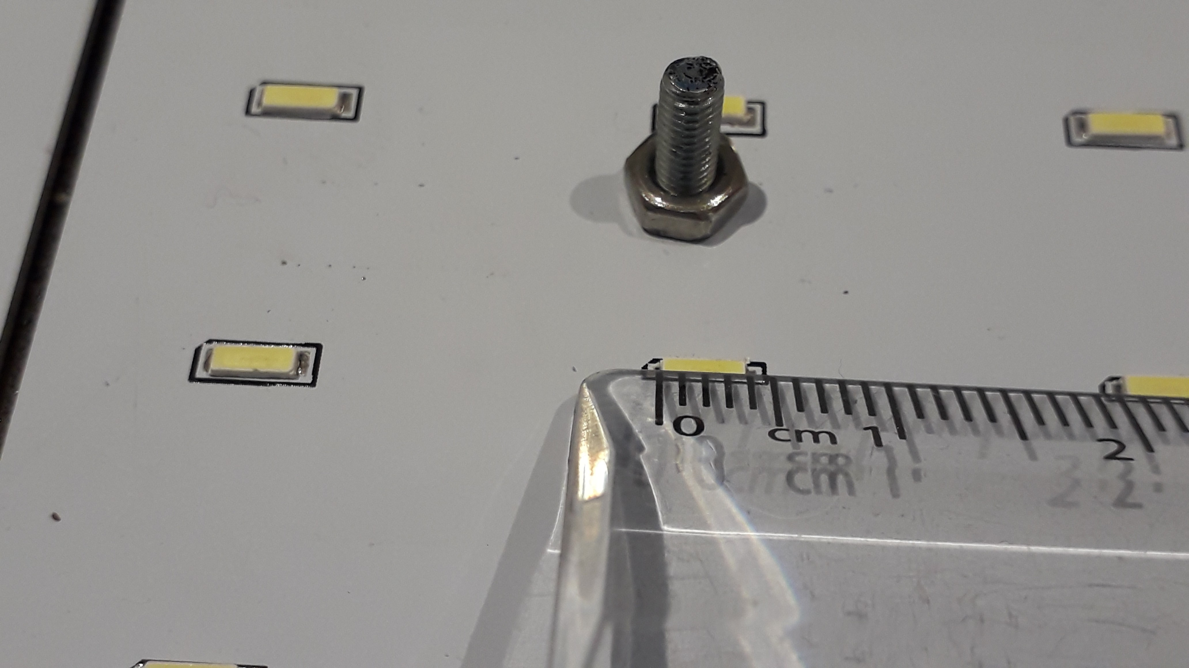

I am looking to identify the LED pictured in this post please. Its from a high brightness LED display (2500nits). I have 3 LEDs that are damaged and am looking to replace them. They measure approx. 4mm x 1mm. Any advice is very welcome.

The critical parameters are operating current and forward voltage. Also color matters a bit. CREE is one company that makes a lot of LEDs DigiKey sells a lot of LRD devices and they do list the variables mentioned. And their online catalog is good.

Many thanks for the information. Do you know of a way that I could obtain the forward voltage and current while the leds are in circuit? Or a way I can identify the led I'm working with? I have 3 damaged leds, which knock out the whole line that they are on. I can make their respective lines illuminate again by making a link between both contact points where the dead led sat, but this makes the whole line a lot brighter, I'm assuming because there is less resistance with one led removed.

The pictured led is an "SMD" ... they come in different sizes ... 2835, 3528, 3020, 3030, 3535, 3014, 4014, 5050, 5060 and 5730.
The numbers give the dimensions . From your picture it looks 4.0mm long and 1.4mm wide , it's a 4014 , and from it's color cool white.
These are used in lighting products ... not usually sold separately , as soldering is extremely tricky , high chance of overheating and blowing them ...
Good luck trying to replace them!
