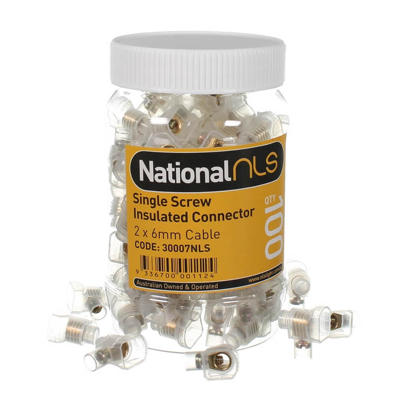

Yep, fair point. The only issue with that (presuming this is how the whole show came out of the hoist when it was operational), is that the second set of motor leads (U2, V2, W2) are mechanically bridged together via a screw terminal, not into some sort logic device like a controllable contactor etc. So basically, in it's current form it is Star/Wye and would only ever be that unless you had pulled the hoist apart to get inside and re-wire the thing.
Can't decide if they used the same motor for both single and dual speed models, or if it's just a single speed motor with some sort of dual voltage ability. Your point is valid though, perhaps it's missing parts for a start up circuit, but none of the wiring diagrams I could track down suggested that this was 'a thing' in those hoists.

No, it doesn't have a typical terminal/junction box like you'd see on larger motors. This is just 6 labelled wires coming out of the motor with bootlace ferrules on each wire. There is a matching terminal strip (mini DIN rail full of Wago push connectors similar to these: https://www.wago.com/au/rail-mount-terminal-blocks/2-conductor-through-terminal-block/p/2006-1201). The push connectors have labels as well and deal with all the control circuit wiring (transformer and fuse connections, contactors etc).
As is, the '1' winding wires connect to the output of the two contactors, which are simply serving to reverse direction in the usual arrangement. The '2' winding wires were just bonded together via a screw clamp thingy (https://www.sparkydirect.com.au/assets/full/30007.jpg?20171026150919). That's how it's currently wired in Star/Wye.
