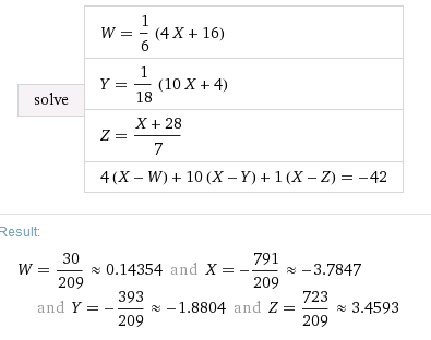

in the instructions say to get only Current from R3 and potency from R4... Shouldn't I ignore the others meshes/nodes?, since I got 2 power supplies in the mesh and 1 on the node..

i got so far
2(I1)+4(I1-I2)=16
4(I2-I1)+10(I2-I3)+1(I2-I4)=-42
10(I3-I2)+8(I3)=4
1(I4-I2)+6(I4)=28
Wah i do from now?....

Equation 1.
2I1+4(I1-I2)=16
2I1+4I1-4I2=16
6(I1)-4(I2)=16
Equation 2.
10(I3-I2)+8(I3)=4
10I3-10I2+8I3=4
18(I3)-10(I2)=4
Equation 3.
1(I4-I2)+6(I4)=28
1I4-1I2+6I4=28
7(I4)-1(I2)=28
Now look how interesting? Did you notice that I1, I3 and I4 can be represented in terms of I2?
6(I1)-4(I2)=16
6(I1)=4(I2)+16
\(I1=\frac{4(I2)+16}{6}\)
18(I3)-10(I2)=4
18(I3)=10(I2)+4
\(I3=\frac{10(I2)+4}{18}\)
7(I4)-1(I2)=28
7(I4)=I2+28
\(I4=\frac{I2+28}{7}\)
Now. Take the last equation: 4(I2-I1)+10(I2-I3)+1(I2-I4)=-42
and replace I1, I3, and I4 with:
Solve for I2.
Once you know I2, find I3. I3 is current through R4. Use Ohm's Law (V=I*R or I think you use E=I*R) to find voltage (potency? potential?) across R4.
Then use I2 and I3 to find current through R3. Remember how we represented the voltage across R3? V=R3*(I2-I3) So the current through R3 is I2-I3. You know I2, you know I3, subtract one from the other. If you do I2-I3 and you get positive answer, than the current is in direction of I2. If I2-I3 gives you a negative answer, then the current is in direction of I3.

its still wrong :/
I1=0.1435
I2=-3.784
I3=-1.88
I4=3.4593
These are mesh currents.
The negative numbers indicate that my original choice of direction was wrong. Remember, I chose that all the mesh currents will be in clockwise direction. I1 and I4 are in clockwise direction. I2 and I3 are negative, that means they are in counter clockwise direction.
Now. Potency of R4. I assume that means potential across R4. You use E for potential?
E=R4(I3)=8(1.881)=15.04 volt
Next. Current on R3. I assume that means current through R3.
I2-I3=-3.78-(-1.88)=-1.9 ampere
I originally assumed that the current will be moving clockwise. In this case from left to right. The negative sign indicate that my assumption is wrong. So if I change direction of the current, then the sign change too. The current though R3 is 1.9 ampere and this current is from right to left.
