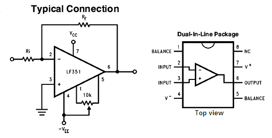

Pin1 [null] -> 100k pot -> 0v?
(There's 2 offset null pins on my dip so I'm not sure if I connect it to 0v or just to the other pin) *edit: after checking a similar datasheet I see pin VEE and both of the balance pins connected to the pot so I'm assuming that's how it works. Although the datasheet shows a 10k pot?
Pin2 [inv-input] -> shunt {load}
Pin3 [noninv-input] -> shunt {source}
Pin4 [vee] -> Common
Pin5 [null] -> ?
(The second null pin I previously mentioned)
Pin6 [output] -> positive of dpm1 input
Pin7 [vcc] -> +12v of PSU Supply
Pin8 [NC?] -> N/A
(Not really sure what NC is but I'm sure it doesn't matter for my use case)

The diagram below shows how to connect the null pot. I can't find a datasheet for the device you're using that shows how to use the nulling connections but I think that chip similar to the LF351 and I have seen datasheets showing 10k and 100k for nulling pot! 10k seems more common so I would go for that - I don't think it will be critical.
NC stands for 'no connection' so you are right to leave it disconnected.
The other connections you have correct.
