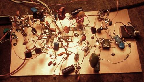

What are these components going to be mounted on?
I will solder them in mid-air. Perf-boards, PCBs, etc are overrated.:cool:;)
I actually will just prototype on a breadboard and then figure out the best thing to do from there. I have some spare perfboards that I may use. I may actually have the finished thing be on a mini breadboard because the breadboards have adhesive on the back. This also saves me time soldering.

And you want to use that for a permanent lighting system in your home? You are going to trust those connections to work properly for years?
And how much do these mini-breadboards cost?
Does your time not have any value at all?

It's not just about penny pinching. It's also about learning how to design a circuit, and implement it. The mini-breadboards were very cheap, and mid-air soldering may not be to terrible here. I could then secure it with hot-glue.
I will go with the schematic crutshow posted. I went on mouser, found suitable parts, and they totaled at 96 cents per board. That's how I know.
You could replace the 40106 with a 555 and avoid the issues of operating schmitt trigger inverters in parallel. Operating normal (non schmitt) inverters in parallel is one thing but the schmitt trigger means that there will very likely be periods at every transition where the outputs are fighting each other. If my CAD programme hadn't decided to be a difficult !@#$ I'd draw up the circuit but since that is not a simple option... the circuit is very similar to the 40106 circuit from Crutshow with the 555 pins 2 and 6 connected together at the top of the timing cap along with the wiper of the pot. Each outer leg of the pot is connected to pin 3 via a signal diode (in opposite directions as per the Crutshow circuit) and pin 3 can drive the MOSFET gate directly (via a gate resistor a bit bigger than usual maybe, around 1k depending on the MOSFET). Pin 7 of the 555 is unused, pin 5 could have a small cap to ground, maybe 10nF but not strictly necessary and pins 4 and 8 connected together and to Vcc, pin 1 is ground. If somebody with CAD tool access had a moment to decode my description and make it into a circuit.... :) that would be great.
The IRFZ44 is a very high current device for the application. Very much a sledge hammer for a walnut ;) but if that's what's on hand... The only actual problem here with over spec'ing the mosfet is that the input capacitance of the mosfet is quite significant so a 555 output could have trouble driving it at any significant frequency.
On the topic of frequency, why so high? An analogue PWM like this could operate at 100Hz or even less without any human perceptible flicker at all. A lower frequency also lowers switching losses and for these types of analogue PWM circuits helps achieve the full adjustment range right to the extremes of 0% and 100%.
