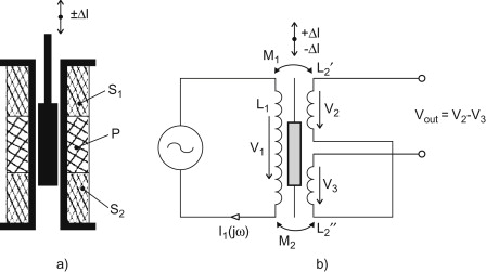

I think its very likely you are making an LVDT type device. If that 's the case, can you live with a lower sensitivity, maybe 20%. then a lower exitation voltage (Say 6v?) will work fine.

The ferrite bars are part of a rotor which can turn 6000RPM and has 12 small (1cm long x 2mm diam) ferrite bars each 30°. There is a transformer nearby (.5mm) and the core consist of ferrite but is open, probably E shaped. On one winding the 600Khz 30V signal is always present. On the other the signal is detected. When the ferrite comes near the transfo, the amplitude rises to 3.5V. When not it is below 1.5V. This signal is then interpreted further on. My objective is to produce the 30V 600khz signal. The currents are probably in the order of 1mA. The gauge of the windings is about 0.2mm for the 'sender', less for the 'detection' windings; don't know number of winding.
The motion is not lineair or rotatory but rather tangential. But indeed there is much rassemblence and maybe the excitation/detection circuits can be very usefull ! You have realised some and with what kind of IC's? The pickup module I have has only two L's.
