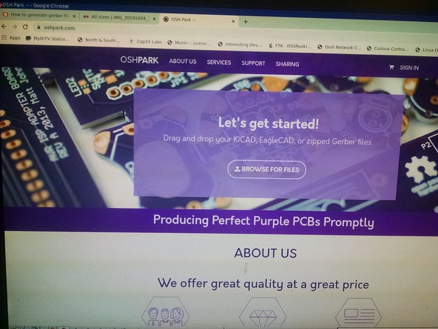

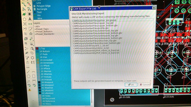

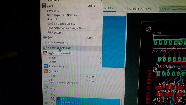

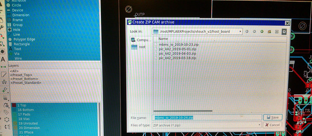

16,322
Generating usable Gerber files with the latest Eagle 9.5.1 version is easy. It creates a manufacturing zip file that most houses can use make your board. With the correct parameters for the board
auto-routing works just fine.
Manufactures like OSH Park will accept the zip file.
