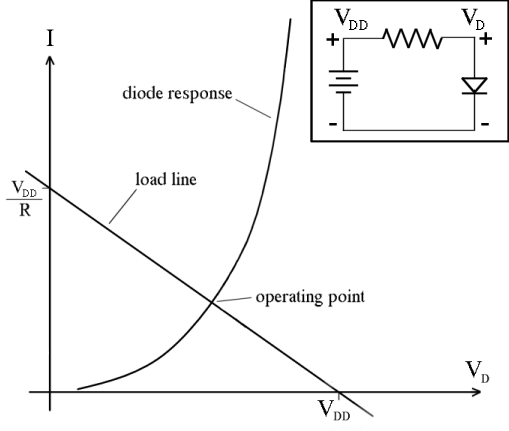

This is another one of those situations where the exact solution is a bit complex. P-N junctions are non-linear devices. You will not find formulas or values for resistances in the datasheets for diodes, zeners, and LEDs.
The I-V curve of a P-N junction looks like this.
How does one solve for the operating I and V of a diode?
There are two exact ways to do this.
1) You can solve this analytically using the Shockley diode equation knowing the temperature and the reverse saturation current.
2) You can solve this by applying the load line drawn on the same I-V curve determined experimentally.
Reference:
https://en.wikipedia.org/wiki/Load_line_(electronics)
A simple pragmatic solution is use the forward voltage of the diode (or the zener voltage of the zener diode) given in the datasheet and calculate the current through the load (series) resistor.
Usually one's goal is the target current through the diode and hence will select the value of the series resistor based on the voltage drop across the resistor, i.e.
RSERIES = (VS - VD) / ID
