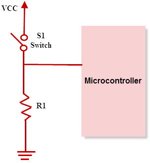

True, so if I did add switches would it just be the spst connected to power with a 1k resistor connected to each?

Default is (1) in this case - when switch is open.
Or, default is (0) in this case - when switch is open.

Hate to keep bothering you about this stuff as I'm sure its really trivial, but if you wouldn't mind I added the switches and would like your input. Do you think this represents it well? The reason I want to put them in is because we had switches on our training device. I do realize that you can't know specifically what our professor would want but I'm pretty sure based at looking at other students hand drawn diagrams he would take just about anything that was close lol. I think this more accurately represents it because you can only turn the whole device on or off therefore the different variables would either all have 0v or all have 5v and you can only represent this by connecting a switch to each one. Thanks!
1) The 5 volt sources you use for the inputs are the symbols for batteries. There is a ground on the negative terminal and you take the 5v from the positive to make the (logic 1) 5V input. It would be better to redraw as you will use a positive rail from your simulator instead of a battery for each x, y and z point.
2) Finally, notice (on your current drawing), that the input is not connected to 5V and it is not connected to 0V (ground) when the switch is open. Also notice that you have no resistor - as in the two drawings I showed you in the previous post.
Is this a better diagram? anything I did wrong or could do better? I just kind of winged it off of what I think you meant. Thanks for the help!

Yes, with the caveat that he may squak because the software is not consistant in the way it shows wire crossings. Sometimes a gap of the under wire when anothe crosses over the top and sometimes not. But, it always shows a dot when there is a connection. So you might want to make a key to indicate the dot indicates connection. Your preference.
