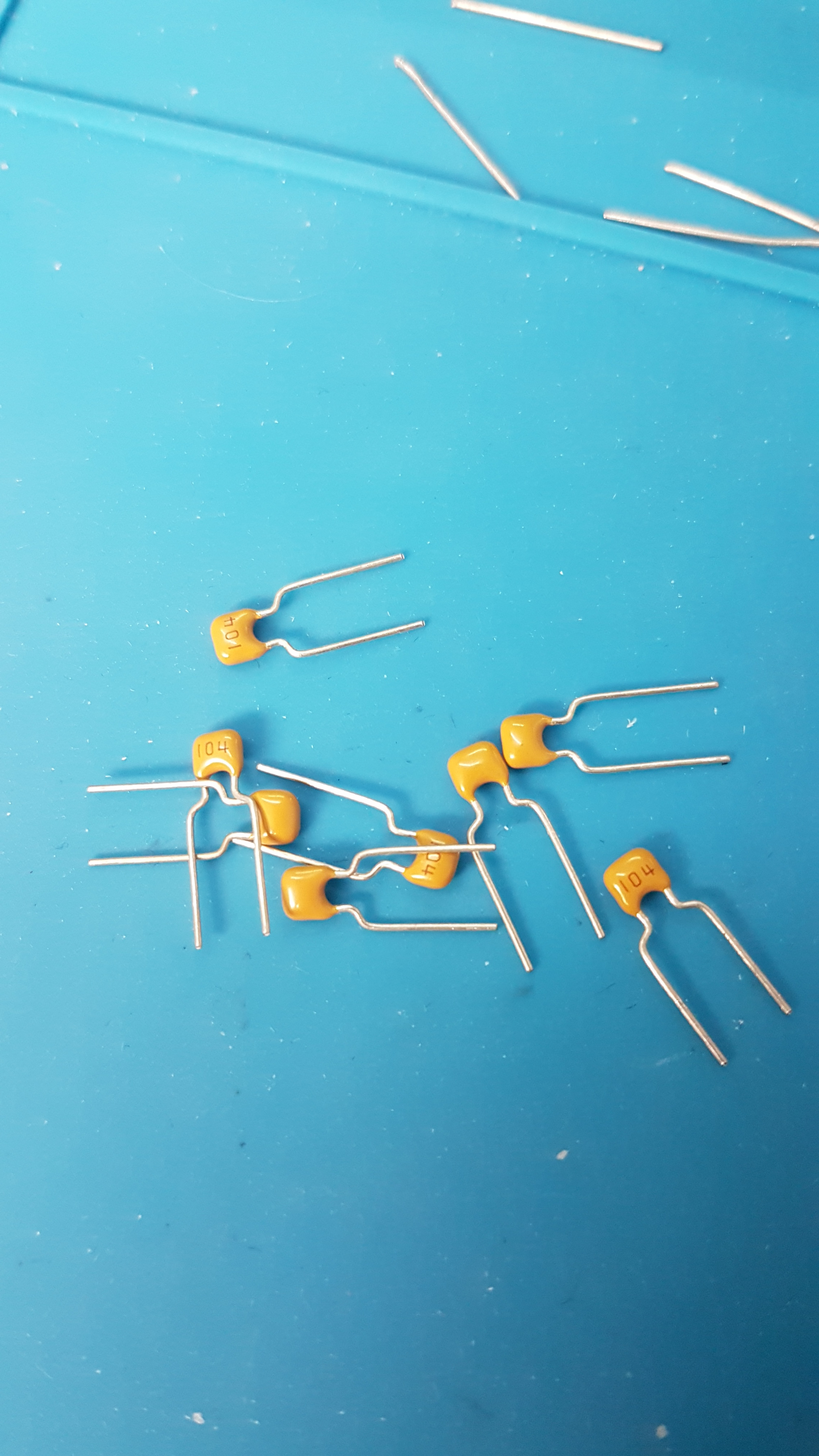

I find these at the shop I'm going to:
https://mixtronica.com/tantalo-condensadores/44548-kit-de-100-condensadores-tantalos.html
They just don't specifiy the exact values of each one. But if they cover my needs for my small project, at that price, I can buy them, for sure. It's not that much!
And can I use tantalum for all of the caps in the circuit? I mean, I have 100nF, 22μF and 47μF. Is it possible to use all tantalum or the higher capacity ones doesn't exist in tantalum?

Well, the shop didn't have enough tantalum capacitors so I had to go for some ceramic disc and also electrolitic ones.
I got 1.6A fuses. They look like electrolitic capacitors but in brown. Cilindrical shape. Hoe thei're fine for the application.
I still have to buy wire appropriate to use with JST connectors. The wire they have in stock was too thick.
Edited:
So, I bought:
6x 1.6A fuses
20x 100nF tantalum
10x 47μF tantalum
12x 1N4007 diodes
20x electrolitic 22μF capacitors
6x 7805 regulators

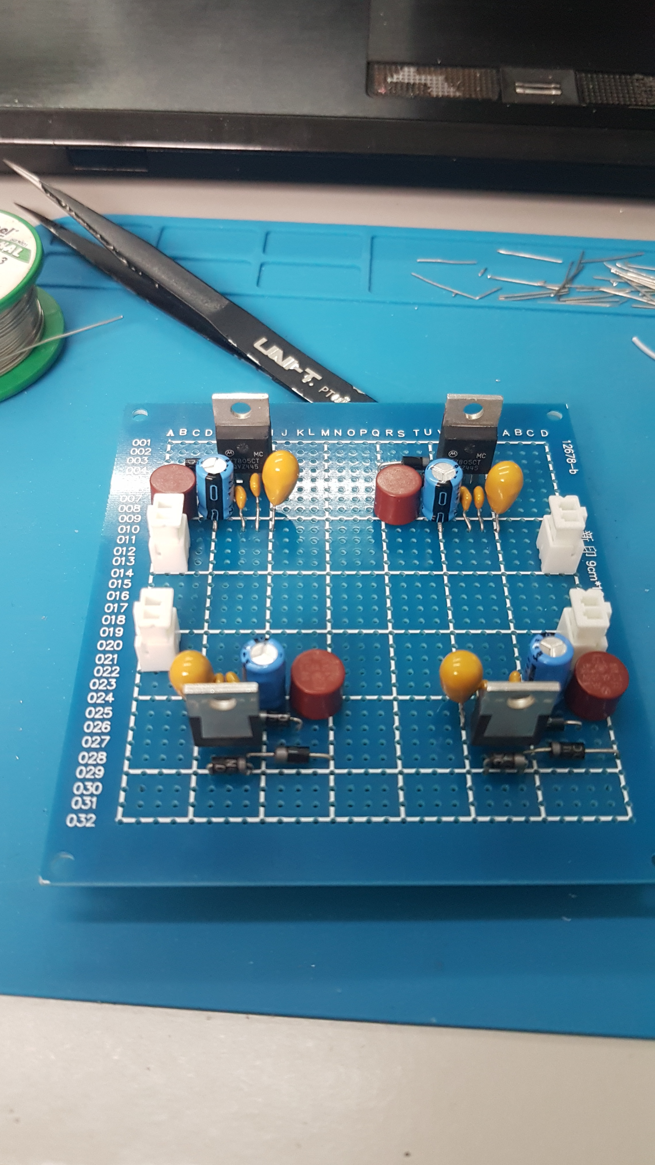

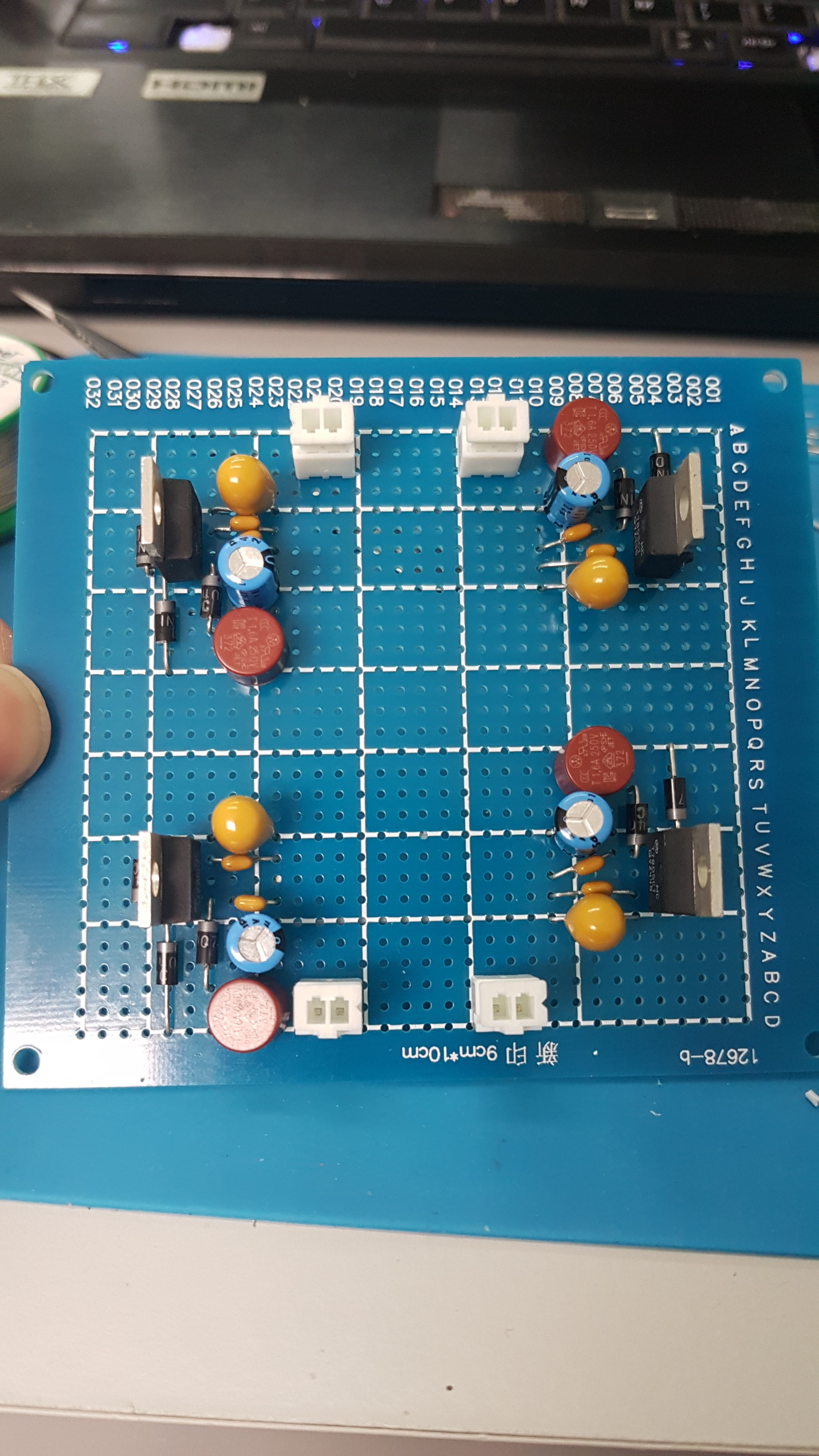

Ok, things are taking shape.
This is how it goes:
Of course I could have used way less space but I'm still thinking about adding switches and leds for each ESP32-cam.
Only the 4 white connectors are not soldered yet!

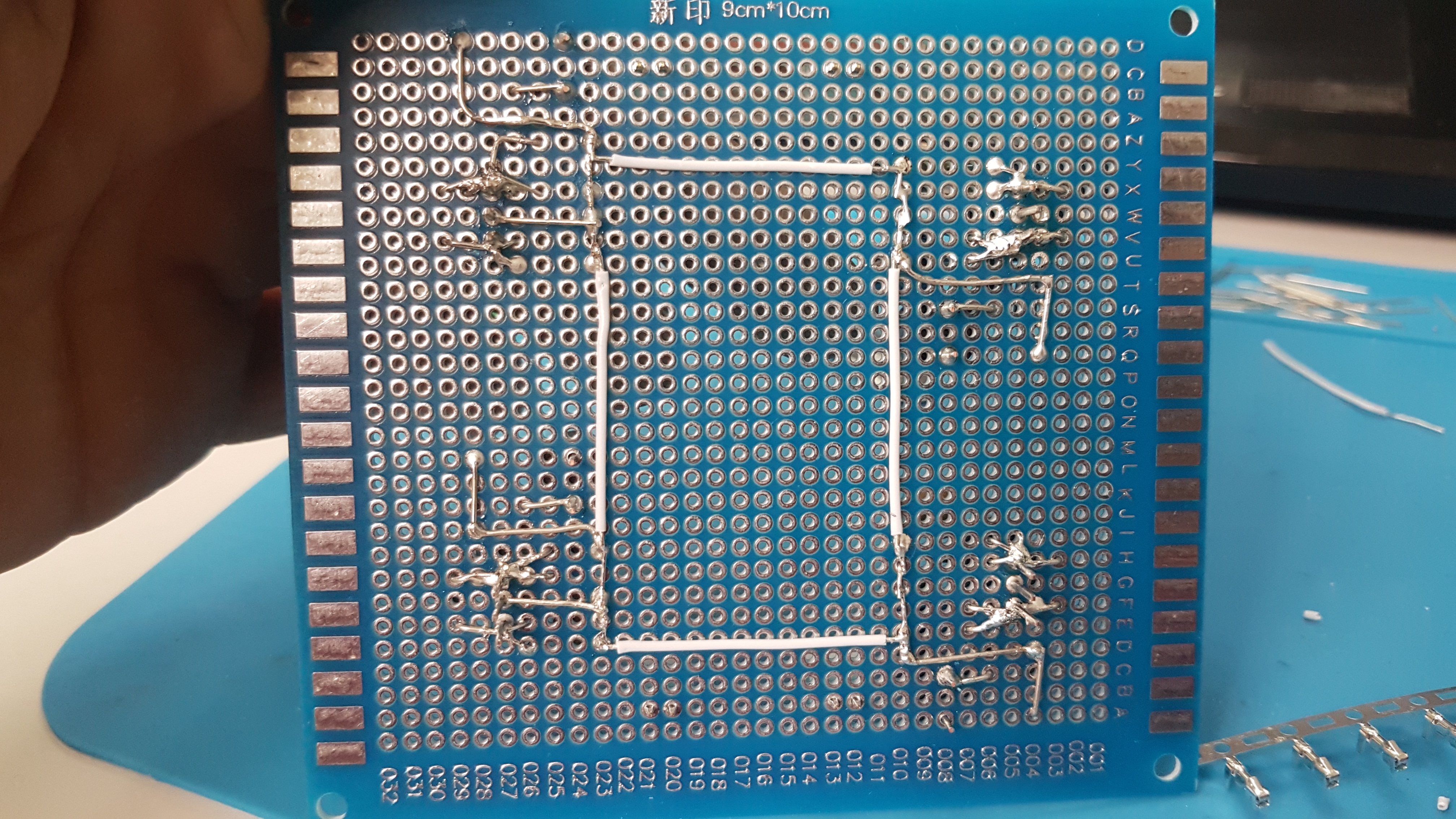

Edited;
There 2 till 2 connections missing, but I'm on them as we speak!
MisterBill2
Joined Jan 23, 2018
28,371
I suggest that instead of having the diodes flush against the board, have them spaced a bit above the board for better air circulation. And if there is any chance that you will want to attach heat sinks of any kind to the regulators, I suggest providing clearance initially so that no modifications to part locations would be required. EAsy to leave space now, more difficult after the parts are soldered.

Parts are akready soldered. I think the diodes wont interfere with heat sinks in case I need to add them. We will see later.
Thanks for suggestions though.
