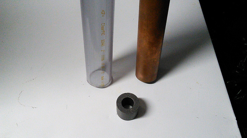

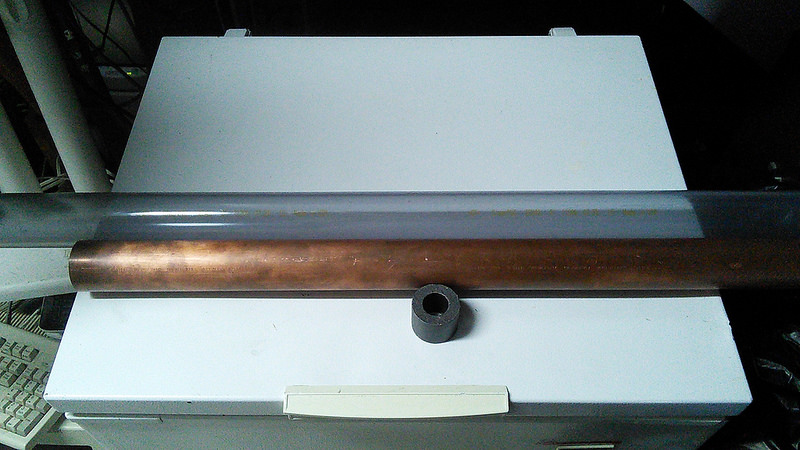

I made a school gravity/electric demo project for my little girl with only three things.
A strong magnet with a hole, a plastic pipe that closely fits the magnet and matching diameter but shorter copper pipe.
You simply first hold the plastic pipe vertical and drop the magnet down it while measuring the time and how loud it hits the bottom. Then you take the shorter copper pipe (that's not magnetic) and drop the magnet down it while noting the same information.
If you explain how picking up the magnet from the bottom of the pipes to the tops gives it potential energy that when released causes it to fall down the plastic pipe quickly as kinetic energy with a loud boom but with the copper pipe it moves down slowly with a gentle tap on the bottom as energy is converted from gravity to electricity from the moving magnetic field that creates an electric field (voltage) causing charge to flow (current) in the copper pipe that in turn creates a magnetic field that slows the magnets fall with the energy of electricity. Then you can explain insulators, conductors and resistance in terms of energy lost when charges move in conductors as electrons. You can do all of this in a physics correct way that's also fun and builds the correct mental foundation to see how the tube amp works.

The experience you described earlier with the magnet dropping through different kinds of pipes was an attempt to give your daughter a sensual experience of something that can only be described metaphorically. The sensual feeling that a kid gets when he holds two magnets in proximity can be described literally using words like "push" and "pull" because the effect is indeed sensual. But the cause of those sensual experiences can only be described metaphorically.
