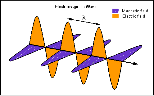

The propagation of electromagnetic waves is a "self contained" process that does not require any medium. Energy is transferred back and forth between the electric and magnetic fields in accordance with Maxwell's law.
16,489
In vacuum the electric and magnetic parts of the wave are in phase. They're two "aspects" of the same thing. It is correct to say that changing magnetic and electric fields generate each other. (simultaneously) There is no energy transfer between the two, only a relationship that both, together, simultaneously carry the energy.

Therefore, we must conclude that an electromagnetic field is a dual entity always having an electric and a magnetic component simultaneously created by their common sources: time-variable electric charges and currents.

Historically we sometimes look at the wave as having two parts because most of the early history of electricity taught them as separate entities in electrical systems. It's clear now that the magnetic field component is a frame of reference transformation result of relativity and charge flow from sources and currents, not a separate energy field from the electric component. The traveling EM energy that moves away doesn't disappear and reform from nothing at the E H null crossings as it propagates, the values are a result of the traveling EM wave origin from sources and currents. The instantaneous value (as momentum in photons) at that point in the waveform pattern of the wave is moving away from the source is a steady state if you were an observer traveling at c (any particle with rest-mass zero travels at this speed) with the wave.
The waves are self propagating as fields in classic EM or moving as photons in QM. There is no need for medium to continually push-off from or travel through because the push-off point was the origin of the wave as a real physical entity in the universe.

An EM wave is its own medium (the electromagnetic field ) in space. It's the actuality that transfers real momentum. The EM wave exists in QED because matter somewhere has changed a energy state (EMF) causing a excitation of photon emission. If you think the electric wave E induces the magnetic wave B which creates the electric wave E in some fashion then the need for a transfer medium makes some sense ( but then you have a instantaneous causality action across spacetime problem) but that's not how it works. It's an electromagnetic wave, not E and B waves.
