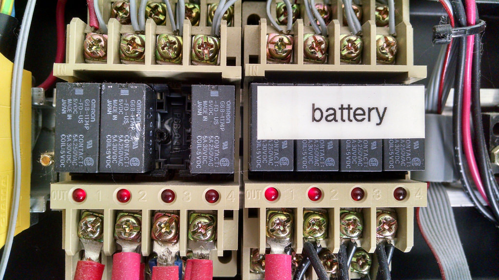

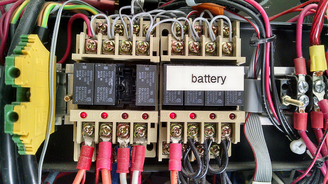

Relays and Sockets, the relays you pictured were designed for soldering the pins to a PCB it looks to me. In the past I have used the linked relays and sockets on pre manufactured boards with upwards of a dozen relays. The boards snapping right on DIN Rail.
