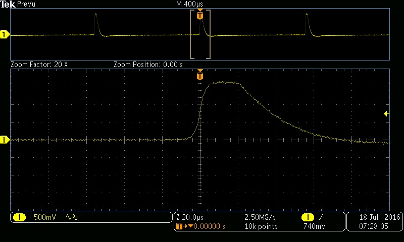

Hello everyone,
Does anybody out there happen to know if this circuit has a proper name? It almost looks like a Colpitts Oscillator. Any help would be great.
Thanks,
Mark

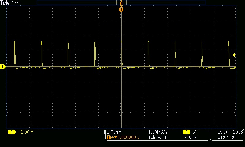

Hi @Jeremy Lee ,
Thanks for joining the discussion. I'm inclined to believe @DickCappels got it right the first time. These pictures are taken by attaching probes across the speaker connections. The blocking oscillator has a metal-core inductor, whereas the Hartleys seem to have air-core inductors, giving the blocking circuit an extremely high L:C ratio.
While those differences are common, the reasons are not what you think. The difference in cores causes a very large difference in the inductance value. A blocking oscillator frequently is used in a audio or other low frequency applications that do not require a sine wave output, or actually need the pulse-like nature such as an old television vertical sweep circuit. A Hartley oscillator usually is used in high frequency and RF applications that need a sinewave output, like a wireless microphone. On paper, either oscillator circuit can use either inductor type, but in practice the natural characteristic differences between the two types of inductors make them preferable in two different kinds of applications.

@AnalogKid It's been a good 15-20 years since I've studied these circuits and an equal number of years since I remembered which circuit was named what or for who. Do you have a favorite source (book, website, etc...) that you could recommend as a reference? I was half-tempted to describe the movement of charges (or energy) around and through the circuit but quickly decided that would lead to death by pitchfork in an online forum. (Don't get me wrong, I'd figure out how to make a tidy sum selling online pitchforks).
And am I correct in calling this a "Single-swing blocking oscillator circuit" or should it be something else?

Yes....though it somewhat resembles a coal pit oscillator, it is actually a classic blocking oscillator.....often used for code practice osculators.
