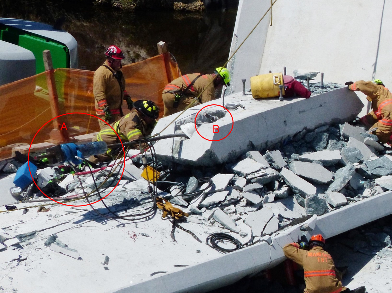

It collapsed when they were tuning the bridge.
I'm thinking they were trying to fix what was broken during the move when something snapped. In single center row truss bridge every single truss is a trip-wire to total destruction.
That's a Hydraulic jack (blue on the cable A) and the blue box to the left of it looks like the fluid tank and controller. I think that cable should be still inside the truss 11 like cable B.
