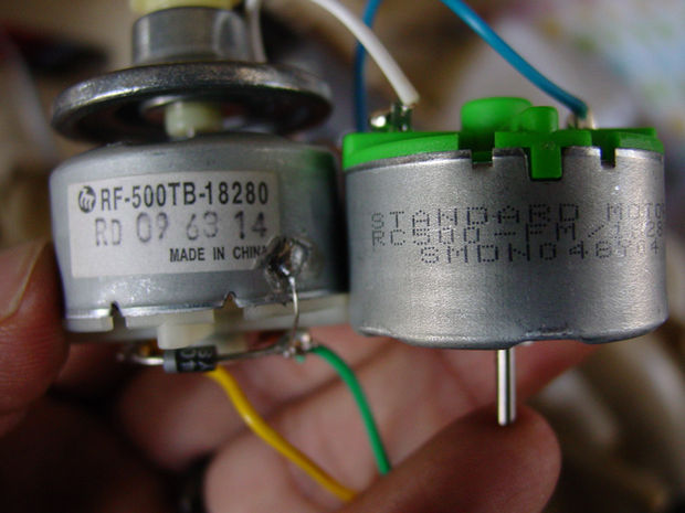

I understand why you guys think the diode is backwards. it looks that way to me, too, but I want to point out polarity markings I think I see on the motor (see attachment).
I should point out that there is no rule which forces the negative supply rail to be ground. It does seem strange that they would use a black wire on the + terminal of the motor.:confused:
Yes, but given that in other images, the yellow wire goes to Vcc through the transistor in question, I'd have to say green goes to ground...
That gets me thinking, what are the chances the motor is attempting to turn in a way the worm gear prevents, stalling out and killing the transistors. The wires used are the wires that came with the original motor, so the direction may have changed....
See Step 4 of the motor swap out.
The new motor is from a Glade auto air freshener, which uses blue/white wires for the connection.
He shows them next to each other, but one upside down, perhaps he swaps polarity so the motor will turn in the right direction? The swing itself uses the green/yellow wires to power the motor.
In other words, it's a hack rather than a direct replacement, but I don't typically put instructables very high on my "solid information sources" list.

The picture I posted if from the OP's post #19.
I'm sorta color blind. I see now that the wire that I called black is really green. In any case, I don't think our OP swapped motors, did she? It looks like the cathode of the diode on her motor connects to the + terminal of the motor (which would be correct, unless the motor is wired backwards), and to the motor case.
I think that is where the confusion lies.
From the OP:
As far as maintaining the direction, I did this a long time ago so I can't remember for sure. I followed the instructions on that website.
From the site:
A comparison pic of the 2 motors. Left with the white cap is from the swing, right with the green is from the air freshener.
The diode is pointing toward the yellow wire in the non-modified "white cap" motor, which I'm guessing is the original swing motor from what was stated.
