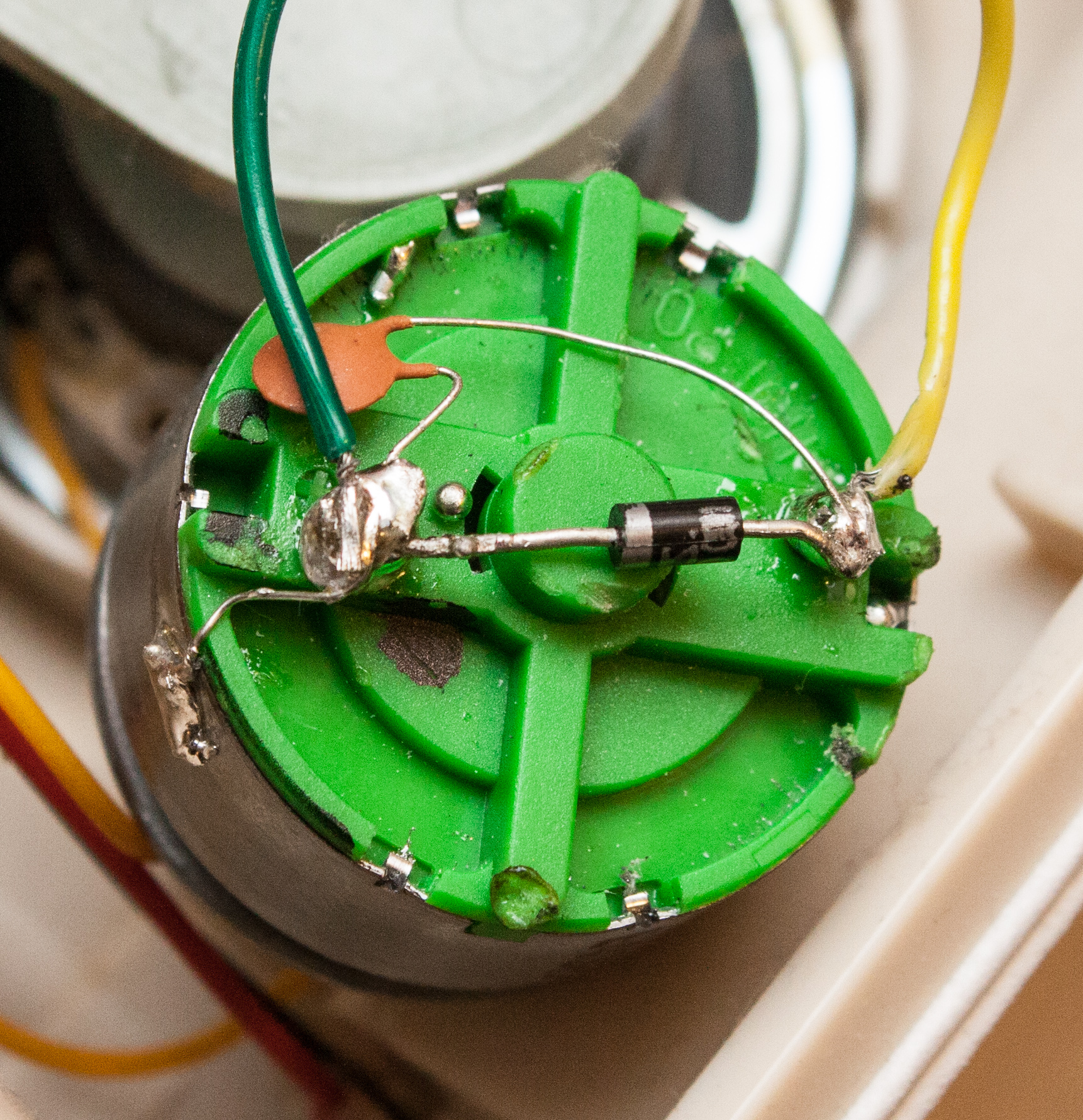

  18. tshuck
    Well-Known Member
    Oct 18, 2012
    3,527
    679
    Sorry to be nit-picky, but can we get an image of the back of the motor, where the diode and capacitor are?
  19. rkwest
    Thread Starter New Member
    Feb 23, 2013
    20
    0
    Here you go.
    [​IMG]
    Yeah I know the soldering is abysmal.
    EDIT: As far as maintaining the direction, I did this a long time ago so I can't remember for sure. I followed the instructions on that website.
  20. tshuck
    Well-Known Member
    Oct 18, 2012
    3,527
    679
    Perhaps someone else can verify, but it seems your diode is in the wrong direction. This could be a reason for a fried transistor...
