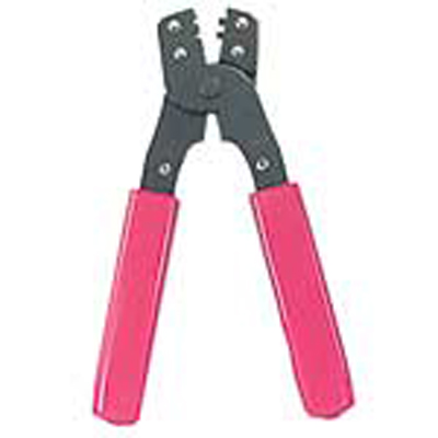

I used to use tools like this:
for crimping connectors like this:
But a ratcheting crimper like this:
was $12 shipped and made crimping much easier.
