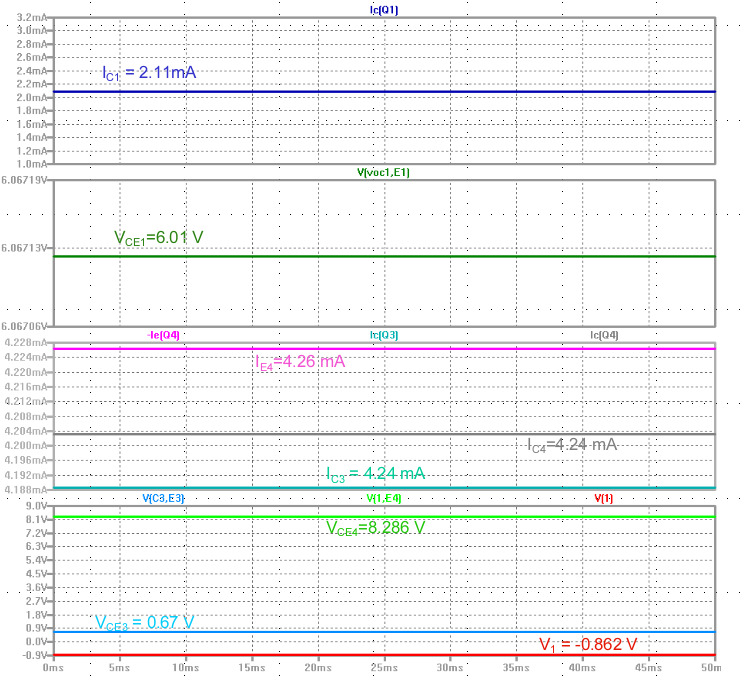

I think I have found a small difference between IC3 and IC4. In fact I_RC3 = IC3 + IB3 and IC4 might be different because of that... I probably assumed, wrongly, that IB3 = 0A
Well
I_Rc3 = Ic3 + Ib3 + Ib4
PsySc0rpi0n
Joined Mar 4, 2014
1,786
Well
Ah yes, you're absolutely correct, of course!
So, what would you suggest to simplify things regarding to the Q3 and Q4 Q-points? To consider both IB3 and IB4 as so low that can be neglected??? Or what should I neglect or consider to make those 2 transistor's Q-points the same?
PsySc0rpi0n
Joined Mar 4, 2014
1,786
Ok, I think I have this correct... LTSpice confirms my calcs!
IC3 differs by around 20 μA from IC4 which I think can be neglected! The Q-point of Q3 and Q4 can't be the same because we have different impedances on both Q3 and Q4 collectors. So, current is roughly the same but not VCE. So I think I'm quite happy with the results, I guess. Please let me know otherwise!
