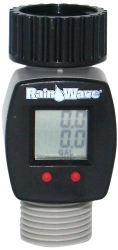

Just chiming in on this thread, but: (first 90 seconds are the point) Beyond detecting the slightest movement, which they seem to know when I have a dripping faucet, you can later upgrade to measuring the amount of water to have passed through. Perhaps the water company might have some older models they would part with for cheap. You don't seem to care about accuracy, so - - - .
