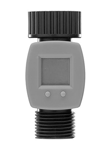

Your paying for WiFi on that one. Doesn't really give any info on the detect method. The cheap flow measurement method is the venturi tube. Then there are differential pressure across an orifice plate, Coriolis effect, and even nuclear gamma-ray devices. Coriolis and nuclear are bot "Non-Intrusive" devices and measure from outside the pipe. Somewhere there should be a flapper valve type indicator device that when the fluid in the pipe flows the flap swings opens and pushes out an external indicator and also serves as a check valve but I'm not finding one.
