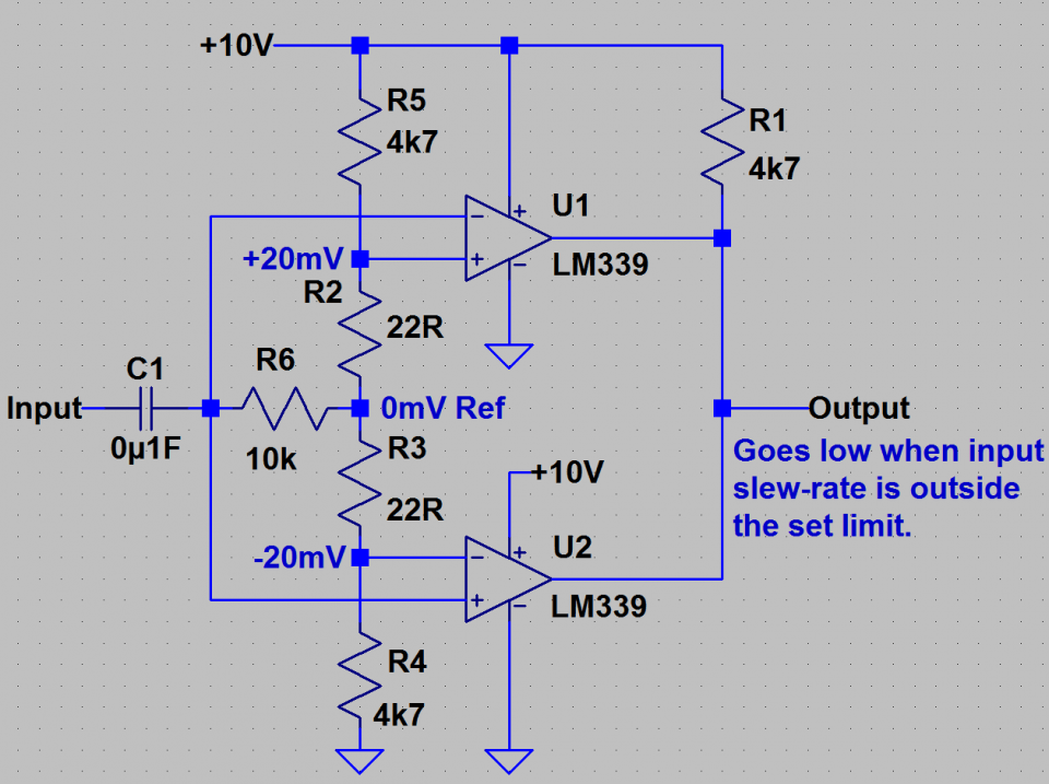

I want to detect whether potentiometer output voltage is increasing or decreasing and convert this to a digital signal.
the circuit must be able to sense tiny voltage changes (order of 10mV) and with high speed.
all im interested is if Vout increases or decreases not by how much
increasing V =high output
decreasing or stable V =low output
how can i achieve this?
please help

How long do you want the output to stay low or high? Until the next change? Only while it is changing? What level does it stay at while the pot position is not changing?
Sumit Aich
Joined Dec 3, 2016
100
increasing V =high output (stays high until V stops increasing )
decreasing or stable V =low output (stays low until V starts increasing)

Build a peak detect circuit with an opamp, diode and capacitor.
Detect when the capacitor is charging. Discharge the capacitor with a resistor across the capacitor with the appropriate RC time-constant.

Your overall approach is a good start, but it needs adjustments to make up for real world components.
You need a slight DC bias difference between the two input pins. With your circuit now, when the input is not changing, both inputs are exactly the same, and the output will not be the same every time. Depending on the input offset voltage, it might be high, low, or a noise burst.
Besides a bias difference, you will need a better comparator. You want to detect a change as small as 10 mV, but the 339 internal errors add up to more than that.

Below is the LTspice simulation of my take on a circuit.
It uses an opamp differentiator circuit to convert the slope change into about a 1V step signal to minimize offset effects. This goes to an opamp comparator circuit to give the desired positive pulse output for a positive slope on the input, and zero volts otherwise.

but in my case Vin is not a Voltage source.
will this circuit work for pot output
Yes, it will work with a pot output.
Your pot outputs a voltage, thus it is a voltage source (with a maximum series equivalent resistance equal to 1/4 of the pot resistance).
What is the pot resistance?
The voltage source in the simulation just simulates the change in pot output voltage.
