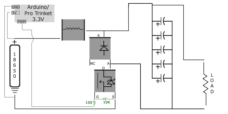

A couple things to still consider is
1) capacitor placement - capacitors should be placed equal distances to the diode AND the output cables so that they share current as good as possible.
2) ALL wire lengths should be as short as possible. The power supply would preferably be done on a PCB or a copper plate breadboard with large fat traces on all high current nodes.
3) All wires and traces should be as short as possible
4) All wires should be twisted pair minimizing loop paths.

That one cap will be useless in the circuit Far too much inductance compared to the others. Try to group them in a 3/2 bunch like bowling pins.
Polarity on an inductor is new to me. polarity shouldn't matter.

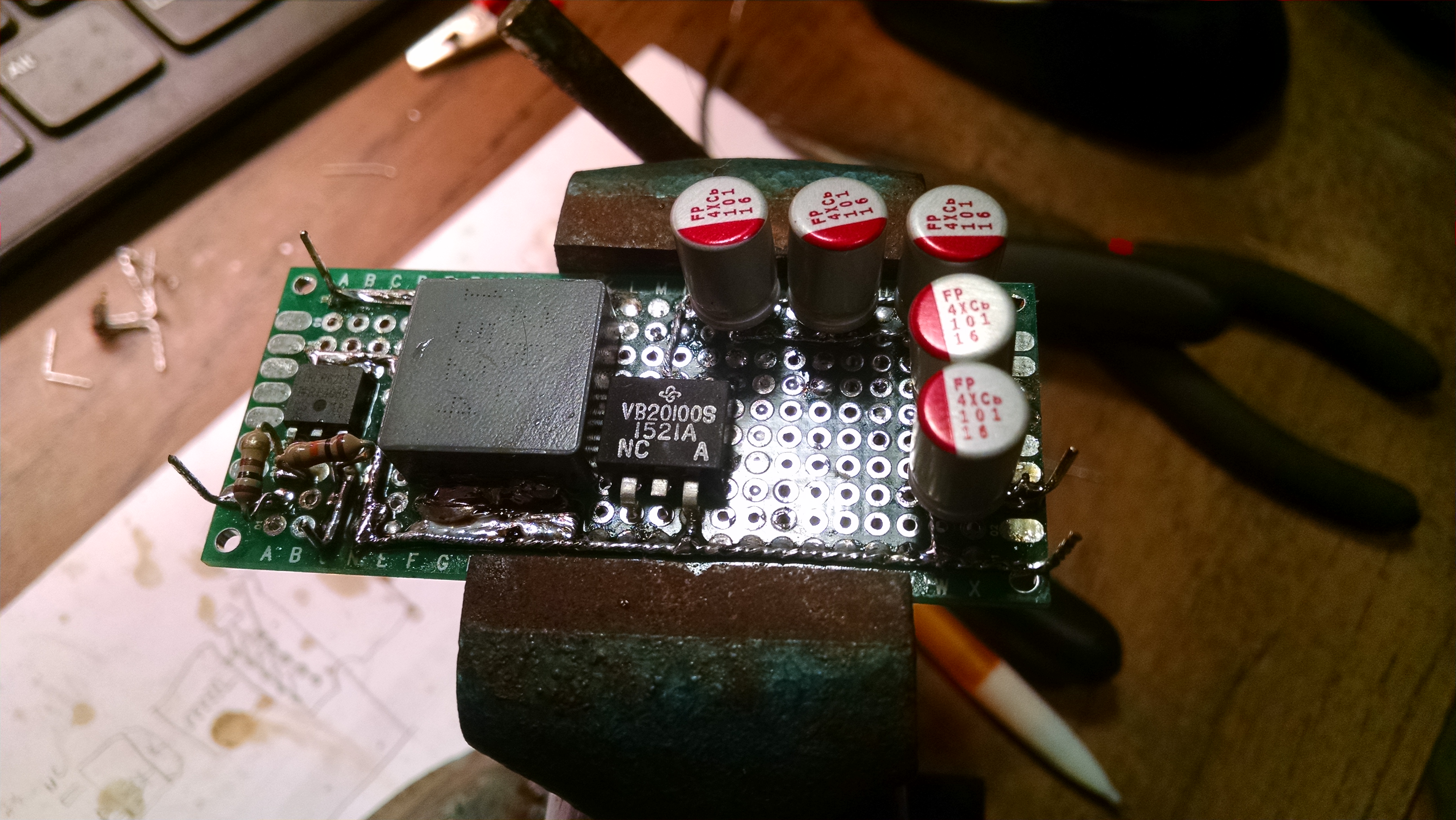

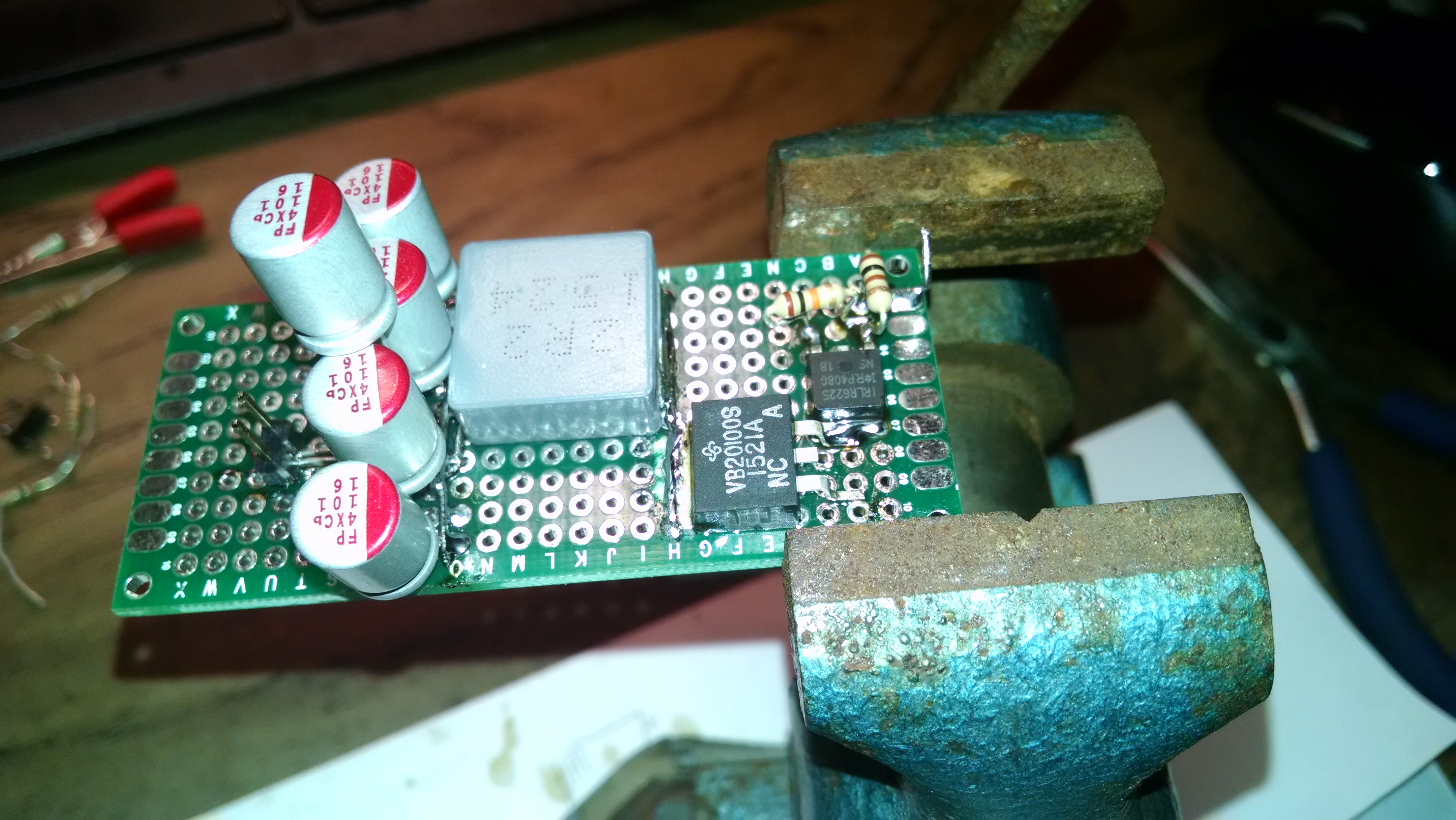

Well Tindel I haven't fired it up yet, but I finally got those caps worked out. Just couldn't get a good bowling pin config. Or at least I couldn't wrap my head around it. So here she is!

Okay, I see my mistake. Ground from mosfet should not connect to Neg of caps. removing that and grounding caps from battery makes it work.
bumba000
Joined Oct 7, 2015
97
No. I made a big mistake when soldering up the circuit. Look closely at the pic I put up. From fet drain to inductor to diode anode to cap neg. My work did not match my schematic. That's a problem. remove the connection from anode to cap neg and it works. I'm pretty sure I've explained it properly, but then again I am learning as I go. I still have a long way to go.

Tindel you're an animal! This is working great. I think I'd really benefit from a real oscilloscope, but this is working way way way better than anything I've come up with in three weeks. I did move my diode to stop my load before button press, but you definitely kicked it's ass.

No the new schematic is how it works. Well the first works too but wires got crazy hot and the mosfet and resistors would smoke. The diode being after the indutor was letting the the charge stored in the inductor go in both directions out of the negative side. Power was able to travel left toward the mosfet or right toward the diode. Placing the diode between the mosfet and diode lets power flow out of the inductor negative side and only travel to the right toward the caps.
I know now that there is no positive and negative side of the inductor but I'm referring to pos and neg by how it's connected. So each time the mosfet would turn on it was a direct short from Pos to Neg and then in the mosfet off time the inductor discharge would come all the way back to the mosfet. Moving the diode is protecting the mosfet in both the on time and the off time.
I sure hope I've explained this at least close to well enough.

But it doesn't make a boost regulator either. :D The positive voltage just passes thru the inductor to the load. The FET and diode don't do anything.
If the first one was wired right, it could be the pwm from the micro was to low a frequency or it was always positive. Either of these would make the current thru the FET very high.
