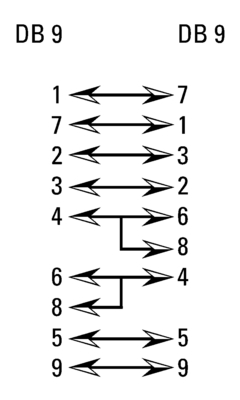

Most modern notebooks do not come with a serial port. But I am sure your school(as this is a school project I guess) have some USB to serial port converters you can use. This is the pinout

Here's my understanding:
Given that the two laptops ima be doing the serial communication with have no serial port, I'll have two 'USB to RS232 Serial Adapter connected to both laptops then I'll use a 'null modem cable' to actually connect the two computers, am I correct?
I got a question though, in the internal connection of this 'null modem cable' (female to female) only pin2, pin3 and pin5 are connected together. i mean pin2 connected to pin3, pin3 connected to pin2 and pin5 connected to pin5. am I correct? And all I have to do is connect this 'null modem cable' on both side of the RS232 serial adapter

Another concern regarding my second paragraph:
This 'null modem cable' have 9 holes on both side and I won't know how the internal connection has been set up...I'm saying this coz in a pdf file (got on google) I been reading, it describes 4 types of RS232 serial null modem cable wiring...(without handshaking, with loop back handshaking, partial handshaking and full handshaking)
Now the problem is I won't know the type of hanshaking the cable I will get is (unless clearly mentioned!). in case no description have been provided, wouldn't be wise to connect ONLY pin2 to hole2, pin3 to hole3 and pin5 to hole 5 on both sides between the RS232 adapter and null modem cable??

MrChips
Joined Oct 2, 2009
35,093
A NULL MODEM will cross connect the hardware handshake lines. You can ignore these connections or you can go to the Device Manager COM port hardware setup and select Flow Control: None.

t06afre
Joined May 11, 2009
5,934
allright, then I will connect the null modem cable as it is and NOT connecting individual pins, correct?
thanks!
If you do not use handshake. And also turn it off then using a terminal program like hyperterm. Or in your program. It will work using only pin 5, 3, and 2. Pin 2 and 3 must be crossed in the cable.
