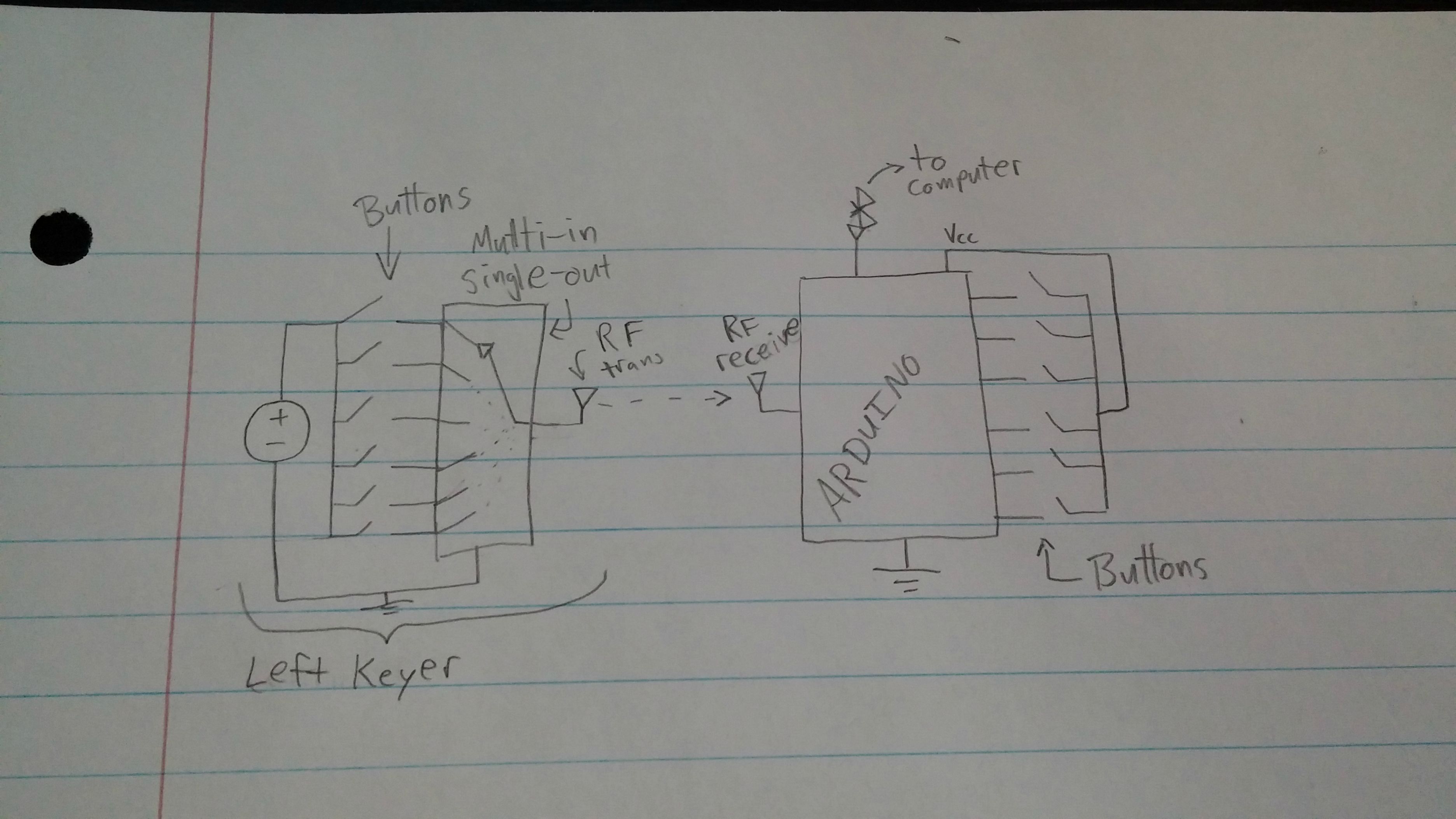

So I'm building a couple of custom keyers (http://i.imgur.com/eHos1yi.jpg), but I've run into a problem with the circuitry. I can explain how it's supposed to work as a keyer if need be.
My idea was to use one of the smaller arduinos (nano or micro, I forget which) in one of the keyers while the other simply had a multi-in, single-out ic that would go down the line of keys, thanks to a timer, and send them through RF to the keyer with the microcontroller.
Essentially, one controller sends a hex value to the controller constantly and if there's a 1, it's a keystroke. But what specific circuitry do I need? How do I get the timer to make the MISO to cycle through the keys, what capacitor do I need so the timing is right, what program do I use to simulate this, where do I ground it all?! It's madness.

Sorry about that, I'll try to be clearer. Man, I didn't even explain what a keyer was. Essentially a keyer is just a keyboard but not in the traditional set-up (DataHand, for example). It's meant to take keystrokes, like a regular keyboard, and send them to the computer, like a regular keyboard. The only difference is that it looks different.
There's going to be a left keyer and a right keyer with 4 regular keys, and 2 shift keys (on top) each. The 4 regular keys will enter letters and symbols, and the 2 shift keys will change what the regular keys input (like when you click 'shift' on your computer, it changes all the letters to be capital letters and all the numbers to be symbols). Since I'm not going to connect the two keyers together, I'm sending the information wirelessly through RF. Instead of buying two microcontrollers, I thought that I could get away with using only one microcontroller. The arduino board would be in the right keyer since, if I was going to implement an optic mouse that's where it would go. So now I had a problem: how do I send information from the left keyer to the right keyer? My solution was to use a Multi-Input, Single-Output (MISO) ic to shift through keys and shifts in a sequence (keys 1-4 then shifts 1-2). It would send something similar to this, where x means "doesn't matter" [xx01 0100]. This means that the 1st shift button is pressed, along with the third key (which could mean I meant to type "g"). I called it a hex value, but in reality, the RF is just sending 1's and 0's and the arduino board in the right keyer is interpreting them is sets of 6. So then the right keyer receives that bundle of information, stitches it together with its own keystrokes to understand what letter/number/symbol the user wanted (e.g. Right: 1000 10, Left: 01 0000, Together: 1000 0001 0100 = "g"), and then tells the computer what keystroke it was. Please tell me if I failed to communicate properly, that was a lot of text.
The problem I'm having now is that I don't know how to design a proper circuit for this. I'm drawing up a quick circuit diagram for the general idea of the two keyers.

If this is all you've got, I think you will struggle as it looks like you need someone to design it for you.
Forums are Ok if you already have something but require a little help with specific questions but if you present an ambitious project idea and say "I don't know where to start" then you've got a problem as electronic design is a very time consuming process.

I just need help with sending information from the left keyer to the right one, the MISO/RF portion. I can probably figure everything else out from there since there are other resources for using arduinos as a keyboard.

I'm curious why you don't want to use another Nano or Micro or something similar, because you'd be able to effectively change the circuit by changing the programming; whereas with logic ICs (like 4000 series CMOS or 74xx series) you would have to swap out ICs and re-wire to change the circuit.
You can buy Arduino Nanos on auction sites for just a couple of dollars. Add an RF module for a buck or two to both Arduinos, and you're done. You can do all of the switch debouncing in programming.

I was doing it because it's cheaper (didn't know about this site until a couple days ago), and cause I thought it would make for a good challenge. I feel like I've relatively solved the issue, but I still don't know the proper way to design the circuitry (could I just hook buttons and the RF to a second board and that's it? Or do I need a resister between the buttons and the board? Do I need a small capacitor between to account for the bounce that occurs when a button is pressed?).
But I guess I'm just gonna take the easy solution then.
So, you say you've "relatively solved the issue"; have you selected the hardware but don't know how to connect it? Have you an example of the "MISO" that you're considering using?
Whatever you use; key debouncing will be necessary and possibly pull-up resistors on the inputs to... whatever....?
A micro-controller is probably the best way forward but it's very difficult to know, from what you've written, where you are with the whole thing.

I don't think that. Neither should anyone else. It's an interesting application that could be solved in a number of ways, each with strengths and weaknesses. One of your requirements will be power; did you have a source in mind? Having them wired would enable using "wall wart" type plug supplies and possibly eliminate the need for the RF modules, but adding the problem of metal fatigue.
One added benefit of using microcontrollers in both units might be that you could make them both identical, and have the software reflect which unit will be master and which slave.

As for power, I figured I could strap enough batteries together to get enough power, I'm not sure what parts I'll need yet, so I don't know how much power I'll need. I'm perfectly fine with using two microcontrollers (now), but I'm rather adamant on then being wireless.

When Arduinos were brand new, they weren't cheap. Nowadays, if you do just a bit of looking, you can buy 3, 4 or more Micro or Nanos for $10 on auction sites. Same with the RF modules.
Sometimes, it's fun just to "roll your own" designs. However, you will likely have a much greater chance of success if you use COTS (Commercial Off-The-Shelf) modules and plug them together in a logical fashion, and program them to accomplish the objective. It's a LOT easier to change software than hardware.
If you're planning on making more than a few of these, then Arduinos might not be the best platform. However, it's great for prototyping.

You really want something like this..
https://learn.adafruit.com/introducing-bluefruit-ez-key-diy-bluetooth-hid-keyboard/overview (adafruit is out of stock but others have it)
Bluetooth right in the keyer and forget about something physically attached to the computer..
Bluefruit EZ-Key (google it and away you go)..
This very much is something I'm looking for. I like how they explain all of their pinouts and tell you how to perform common, basic, ideas with those pins (like adding an external button to the Bluetooth pairing button pinout. Thanks guys
