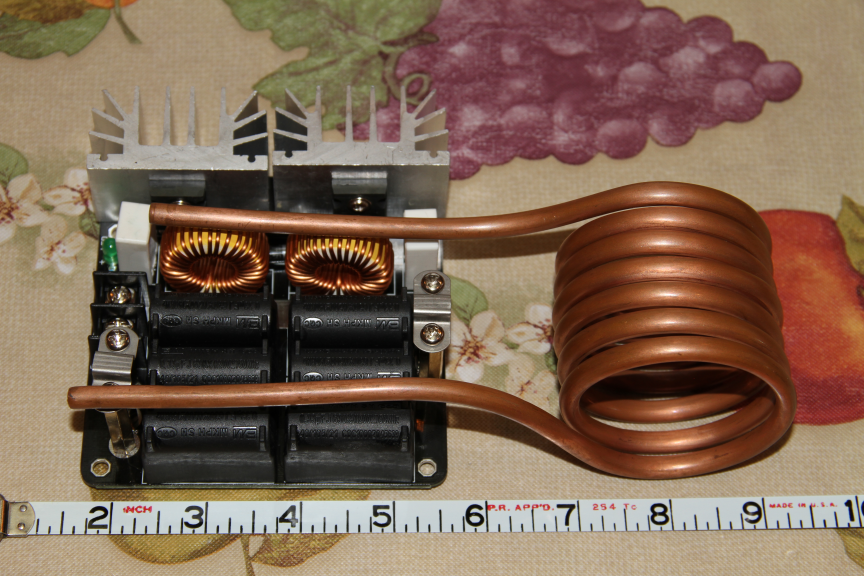

Hi I have an induction heater and I want to install a electrical power fuse for the induction heater .
The heater runs at 13 amps .
My question is will the induction heater take more then 13 amps under Long operation hours ?
I am thinking of installing a 15 amp fuse for protection.

When you first turn the heater on....it will draw more than 13 amps. Usually a fair amount more. Put a 13 amp fuse in and see.
They make what is known as a slow blow fuse for these applications. They can take a short high current pulse without blowing.
15 amp slow blow should work.

Where would you place the sensor for an induction heater which is what the original poster mentioned? Not like there is a heating element to place a sensor on. Here is an example:
The copper coil does not get hot, nor do the driver transistors. The load to be heated is placed in the Cu coil. So where would an overtemp sensor be placed?
