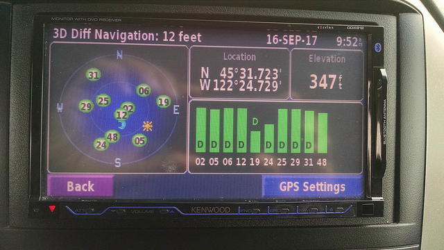

Hi. Never had one, never played with one, and will have to buy one.
But I have seen the screen showing a bird's view of the road.
Can longitude and latitude display be selected instead of graphic maps ?

Some allow custom map fields for longitude and latitude display as an overlay. RTFM.
2# Unlikely to work with a different chip unless that units firmware already knows how to handle that chip.

Once the coordinates are known, the rest of what is displayed is software, and that depends on the specific device and the software it's running. I would be surprised to find any GPS device one that won't give your current coordinates if you want them. The fancy stuff it does with map views, points of interest and so on, is specific to the software the device can run.

Thanks. I learned an (automotive Garmin) user can enter a destination location as coordinates, but have not seen clues on how the user can read current locations in coordinates -latitude, longitude, altitude-
If someone knows an interface to display NMEA on a composite input display, please let me know.

I have several GPS devices. All Garmin. My car GPS only displays the position on the map. No latitude or longitude. I assume that is because it is a dumbed down version and most people that use it will have no idea what latitude and longitude is. I have two other mapping GPS devices. I I used for sailing and the other I used for bicycle touring. Both can display the position as well as the map. I also have an old GPS 12 that displays only latitude and longitude. and I have a hockey puck Garmin that connects to the USB port of a laptop. It will display whatever the software is capable.

Let me first decide and buy whatever I end with, the final wish is something that can receive Galileo, Glonass and GPS, preferably a receiver module. But I have to learn more.
I believe a Galileo enabled receiver module/chip responds to the same commands GPS does, has same pinout, allowing transplant to a plain unit that displays coordinates, as for marine use. Do not care about maps/charts.

Seems all GNSS receivers have 'the secret' which solves my quest. Now I have to find if the green bars above correspond only to GPS, and there is other hidden sets of bars for Glonass, and another for Galileo
You don't see Glonass or Galileo in the U.S. for a simple reason .... http://www.insidegnss.com/node/4334
A rule largely aimed at opening trade in telecommunication services will require Russia and other international providers of GNSS services to apply for authorization before their navigation signals can be legally used in the United States, a Federal Communications Commission (FCC) official has told GPS experts on the Space-based Positioning, Navigation, and Timing (PNT) Advisory Board.
