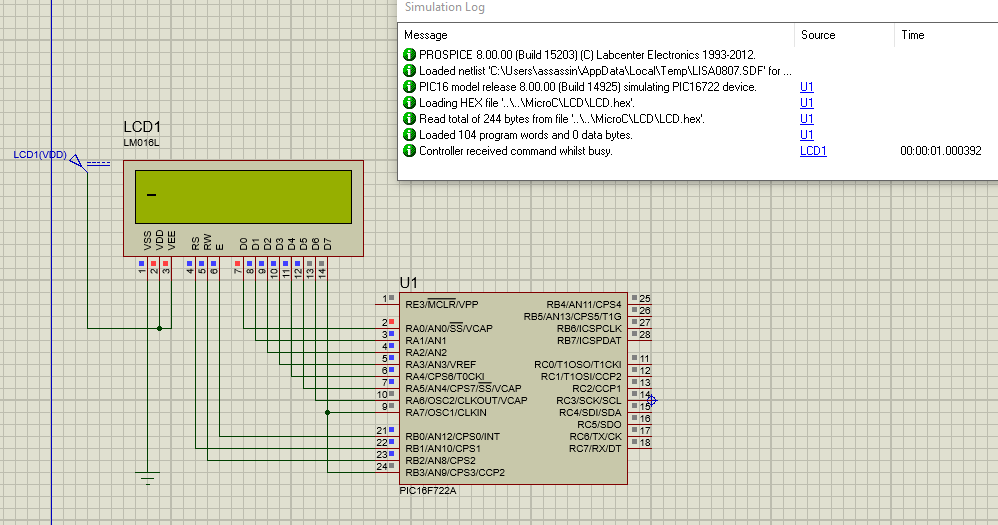

Controller received command whilst busy on proteus
Tajiknomi
Joined Mar 18, 2010
34
I am using LM016L LCD and 16f722A MCU in proteus. I am running a simple program to send a 'single' character to LCD. Program runs fine and the cursor is shown on the LCD but the proteus doesn't show the character. The following error shows that the controller of LCD was busy when the character was transferred but I have already built a function to see whether the LCD is busy or not before the transmission of character.

            LCD_RS=1; // Data register
            LCD_RW=0; // write to LCD
            LCD_DATA='A';
            Delay_us(1);LCD_EN=1;Delay_us(1);LCD_EN=0; // LATCH

JohnInTX
Joined Jun 26, 2012
4,787
C:
void lcd_ready(){
             LCD_RS=0; // Command register
             LCD_RW=1; // Read from LCD
             Delay_us(1);LCD_EN=1;Delay_us(1);LCD_EN=0; // LATCH signal
             while(LCD_BUSY_FLAG); // wait until busy flag is low
You have to leave LCD_EN==1 to read the busy flag. It does not latch on the port and goes tri-state when LCD_EN==0.
Try something like:
C:
void lcd_ready(){
             LCD_EN=0;
Keep in mind that this code will hang the processor if there is a problem reading the busy flag...
