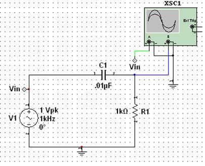

Class AB power amp calculations
Hymie
Joined Mar 30, 2018
1,347
Careful analysis of the circuit diagram shows that the common point of capacitor C1 and the base of transistor Q1 is referenced to earth by the scope – therefore the answer will be zero.
MrChips
Joined Oct 2, 2009
35,186
I am not familiar with simulation suites.
Perhaps that is the way the simulator (Multisim) shows signal and ground on a 2-channel oscilloscope.
