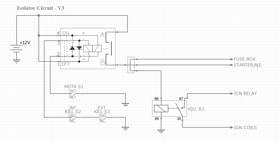

I have drawn up a circuit for an battery isolator with three relays, a TE high current relay (TE V23132A2001B200), a change over relay and a make and break relay and using momentary push switches. For the change over and a make and break relays, I am contemplating using:
* Song Chuan 301-1A-S-D1-12VDC and
* Song Chuan 301-1C-C-D1-U05-12VDC.
These are diode type relays. The data sheet for these is located at: https://au.mouser.com/datasheet/2/378/301-2555.pdf
Does this circuit work as I intended?

1. Your circuit would not work since the relay contacts would stay actuated only as long as the push buttons remained pressed.
2. Your objective could be realised with a single relay.
2.1 By using a standard relay with 3 normally-open contacts, a 'master' push button switch with a normally-open contact and two 'kill' push button switches with normally-closed contacts. However the relay coil would be required to be kept continuously energised in the 'battery not isolated' condition.
2.2 By using a latched relay with 2 normally-open contacts and a 'master' and 2 'kill' push button switches with normally open contacts. The latched relay would avoid the problem of keeping the relay coil/coils continuously energised.
3. In the probable event of only standard automotive relays being available (not latched), there would be no getting away from the standard lever-operated isolator switch!

My comments are as follows:
1. S2 & S3 are to be 'NO' and wired in parallel. By the way, why two 'Kill' buttons?
2. I suppose the cable from the isolator relay 'B' terminal is terminated in a junction box where the cables from the fuse box, starter/alternator and relay R3 coil are also terminated.
3. What is the purpose of relay R3? Doesn't the isolator relay by itself isolate the ignition circuit also? Is the existing ignition wiring required to be altered?

Thanks for the comments. Two kill switches are required by the relevant motorsport regulations. One switch mounted inside the cabin to be operated by the driver and one mounted externally for the crash rescue teams, with either switch to disconnect the battery and stop the engine.
Thanks vu2nan. I think I can now see a possible problem with the NC switches. They are constantly grounded. I am not sure what the NC switches running constantly to ground would do for this relay and whether opening either would activate the relay like I had hoped. With this insight, I think changing to NO switches in series won't help in this case as they'd require the two being pushed at the same time to operate. Not useful if the driver is in anyway incapacitated. NO in parallel would be required as you said.
R3 relay is supposed to kill the ignition stopping the engine, otherwise the alternator will keep the engine running. However I now see a flaw. As it is is wired, the alternator will still supply power to the coil circuit of R3. A rethink is necessary if I plan to use the BDS relay.
I might not use this option. Instead the original circuit using conventional toggle switches rather than the momentary ones. This probably the simplest approach as per vu2nan's original point 3 above.
It's been useful for me to work through this. I'd look at a circuit and as long as the lines complete a 'loop', I'd this "yes, OK" but I need to focus on the logic underpinning it.
