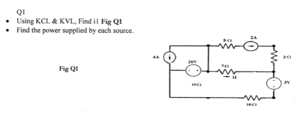

Can someone please solve this circuit?
SeyamMs
Joined Oct 28, 2018
7

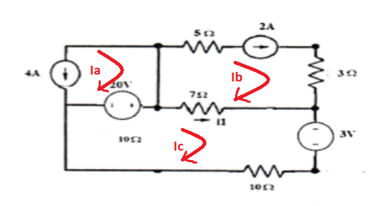

You have two known current values, 4A and 2A current sources. That means you already know two mesh currents, Ia and Ib.
I1 = Ic-Ib. Apply KVL on Ic mesh. You'll see how easy it goes.
thank you so much for your reply but can i use mesh analysis sense the question specified the solving method?
i completed the solution using mesh and my answer is
I1 = -0.18A
is it right?
I1 = -0.18A
is it right?
Mesh analysis is fundamentally just a systematic way of applying KVL in such a way that the KCL constraints are intrinsically satisfied.
But, having said that, you should be able to solve the circuit using KVL and KCL directly since this is the kind of circuit that you would typically be expected to be able to solve just before learning about mesh and nodal analysis. So if you can't, then you probably should take some time with it until you can do so and do so in a confident manner. Otherwise you risk putting yourself in a situation where when you apply something like mesh analysis you are really only regurgitating memorized steps without much in the way of comprehension of the underlying principles.

You already know the answer. Try KVL and KCL directly to see if you get the same answer. I guess you don't want to hear the word Mesh for now.
For your second circuit, take into account that you already know V1 value, which is 5V for the ground as reference node.
Also, the signs of the 10V source can't be appreciated.
