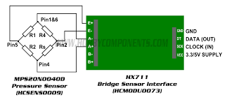

My main question is finding the pinout for vacuum sensor MPS20N0040D-D (as found on ebay and aliexpress) or a similar vacuum sensor that would also do the job. So far various extensive searches yield a whole lot of nothing. Seems to be the norm with cheap Chinese parts. It's really not a big deal for this project.
(Digikey has one, but at 10 times the cost and has two more pins-I can go that route, but for now I want to keep it on the cheap.)
I would like to connect it to my arduino uno analog inputs. I should be able to slog through the workings, so at this time I am simply after the pinout, but if knowing what I am up to helps, read on!

Does this help?
According to this image, the front (as seen) has a notch. If the sensor follows the markings for ICs, the first pin counter-clockwise from the notch would be pin 1.
Sheet 2 of this datasheet shows the notch and pin-out.

Thanks for the schematic, helps immensely. How did you dig that up?
To make sure I am reading this correctly, looks like I connect the V++ to pin 2 and ground to 5.
What are three outputs though 2 - and one +? I just need to send a voltage range (0v~5v) to an analog input pin on the arduino.
