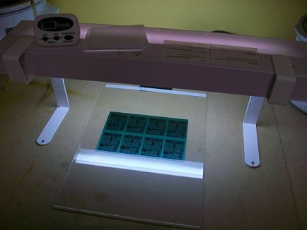

I use the UV photoresist method.
Sensitized PCBs are available from various eBay sellers for $3 per 4 x 6". Cheaper if you order 5 or 10 at a time. "UV" is an overstatement. More like bluish ("cold") fluorescent tubes.

my current preferred method: This printer/UV method, using transparencies (also reported to work with a normal fluorescent bulb). Seems much cleaner and nicer than messing with ripped-out magazine pages and a clothes iron, or feeding the board through a laminator over and over. i'd rather leave the board under a lamp and go play on Facebook for 15 minutes. :)
I prefer this:
to this:
Seriously, if you're messing with a clothes iron and a rolling pin, you need to treat yourself better :D
+ sponge etching:
  • consumes less consumables
  • handling much less quantity of toxic chemicals in an open container.
  • throw less gunk into the environment
  • faster
  • small setup. No tanks, bubblers, or heaters
  • "Undercutting is practically non-existent"
+ mild etchant:
Such as vinegar, hydrogen peroxide, and salt. Some recipes use lemon juice. Ingredients are less dangerous, kinder to the environment, and cheaper and easier to find locally than muriatic acid and Ferric Chloride. (3am? No problem, go to Walgreens). True the milder etchants take longer to etch, but that's compensated by the sponge method, which speeds things up.
The whole setup is basically a cheap home printer, printer transparencies, photo-sensitive pcb's (cheap on ebay, and there are some cheaper alternative methods), my desk lamp with a CFL or UV bulb (for small boards), a coffee cup, and a small bit of sponge. All low-cost, small footprint, and (except the photo-pcb's) easy to find locally. Turnaround time is prolly about 30 minutes (including setup/cleanup).

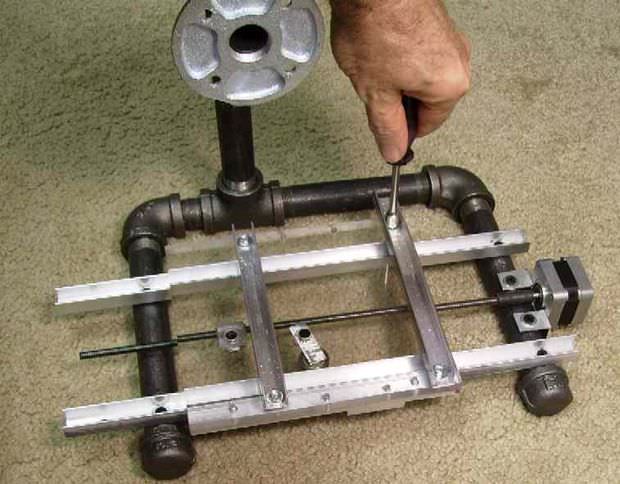

I looked into a variety of mills, which i'll post below for those interested. So far, the best decent-seeming OTS mill i found so far was around $400, so that's over budget. Only way to get a cheaper mill is to build one. I found very few promising $200-ish builds, and a lot of janky-looking builds. But even the decent-looking builds seem to have gray areas in the build-plans. I also realized a mill will take up more room on my workbench than my printer (already here), my lamp (already here), or a coffee cup (already here :D . Also, a mill means potentially copper dust all over the place, which is not so great for a bedroom workbench. And my roommates might not appreciate the loud grinding noise at 3am.
My favorite DIY mill (for amusement factor), built from plumbing supplies :D
https://www.instructables.com/id/Easy-to-Build-Desk-Top-3-Axis-CNC-Milling-Machine/
