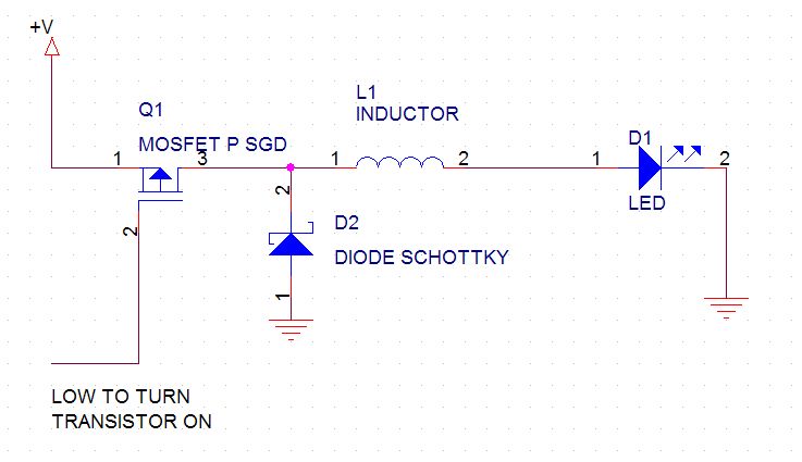

However, if our pointy-haired boss told us to design a driver for an LED to conserve battery power, and we come back with either of those plans, he ought to fire us. We should have used a switching drive with an inductor, like this:
Instead of throwing away energy in a resistor, this driver stores it in the inductor, then uses that stored energy to keep the LED running. It would use that energy to run the LED, so the duty cycle could be less for the same perceived brightness. It's an elementary concept, and it's used everywhere. I'm still a little bemused that I need to explain it--are we really talking about the same thing?

John P
Joined Oct 14, 2008
2,068
This has become embarrassing. A point comes where arguing about basic issues is just painful to do, and there's no pleasure in being right. I'm going to back off at this point.
But Wayneh, how about giving some thought to the last line in my previous post. If you're going to claim that a PWM drive is more efficient than pure d.c., wouldn't the duty cycle of the waveform have an effect on that efficiency? Surely it must, because a duty cycle of 99% would be almost the same as a purely linear system, and if you reject that, I could offer you 99.9% or whatever would convince you. You say your 2% duty cycle is better. So if 2% is better than 99%, how about 1%, or 0.1%? Or maybe there's some "sweet spot" where the efficiency is absolutely optimal. A spreadsheet which would generate a plot of efficiency versus duty cycle would be very interesting to see.
As for hijacking the original thread, I say not so! The basic inductive circuit that I drew earlier (07-16-2013, 11:11 AM) is an efficient way to drive LEDs, without any tedious arguments about what kind of resistor to use, because there aren't any resistors. I admit that an integrated LED driver could probably do somewhat better, but it's a starting point. If this project can be built, it has to be done with maximum efficiency in the lighting.
