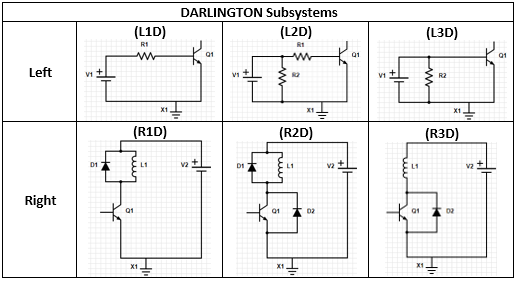

I. Darlington:
To continue, I believe, based off of ebp’s solution process, I should take into account the “forward voltage” of the NPN transistor system of the Darlington pair. In Fig. 1 below, the left subsystems represent 3 different configurations of the base/pull-down resistors with Q1 as the BJT. Using L1D: taking V1 to be 5V and the load current on the right-side system (i2) to be 2A, and assuming the gain of the Darlington is 1000 with a forward voltage (VF) of 1.4V, then via KVL, the voltage across R1 (VR1) is VR1 = V1 - VF = 5 - 1.4 = 3.6V. Since the desired current across the collector-emitter interface is 2A and the gain is 1000, the current into the base needs to be 2mA. Then, using Ohm’s Law, R1 = VR1/2mA = 1800Ω. Thus, if I am using a Darlington for my transistor in the system, I must use an 1800Ω base resistor to achieve the necessary 2A load current through the solenoid.
Solution: R1 = 1800Ω with Q1 as a Darlington, if using subsystem L1D in Fig. 1.
If subsystems L2D or L3D are better suited for my application of the circuit, then please let me know. I am sort of clueless on how to calculate the current into the base in either of those subsystems, however.
I will address the right-side subsystems in a separate section, since they are essentially equivalent for my questions, regardless of if a Darlington or MOSFET is being used (I think).
Fig. 1 - Darlington possibilities.

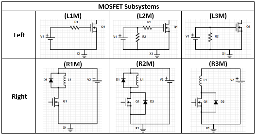

II. MOSFET:
Correct me if I am wrong, but I believe the current into the gate of the MOSFET is nearly irrelevant to its operation, and that the voltage across the gate-source interface is what actually matters. Thus, I don’t really need to calculate the current going into the gate, but I should use at least a 1000Ω resistor in subsystem L1M (see Fig. 2) in order to somehow protect the voltage source (e.g. a microcontroller’s 5V signal output pin) and to minimize oscillations. If you could enlighten me on how the 1000Ω value is arrived at, I would appreciate it.
Since the voltage across the gate-source interface is what matters, it is the important value to calculate. I was assuming that if the voltage source (V1) is 5V, then the voltage across Q1 (the MOSFET, in this case) is 5V and is thus well above a “logic level” threshold value (let's say 2V) to turn on the MOSFET and achieve a fully open condition. However, I am not sure if this is accurate when a resistor (R1) as in L1M is included. I think, but am not sure, that if subsystem L3M is instead used, then the voltage will indeed by 5V across Q1 since it will be in parallel with the pull-down resistor (R2) and V1. However, L3M does not use a gate resistor... And I am clueless about L2M.
Questions: Is the gate resistor necessary? Is the pull-down resistor necessary? Should I use both? How would I know the voltage across Q1 if I used both or even just a gate resistor, as in L2M and L1M, respectively, and is my assumption about L3M even true?
Fig. 2 – MOSFET possibilities.
III. Diode Placement:
Referring to Fig. 1 and Fig. 2: is it better to place the diode across the solenoid (R1D/R1M), across the transistor (R3D/R3M), or both (R2D/R2M)? And since the load current is 2A, is it ok to use 1A rated diodes if the solenoid is only activated one time? How does using both diodes affect the necessary rating (if, in a single diode system, a 2A diode is a better idea, then if I switched to a 2 diode system, as in R3M, would two 1A diodes be equivalent for protecting the transistor)?
BIG QUESTION: Which system combination is best? I was originally considering an L1D-R1D or an L1M-R1M system, but I have specifically seen online an L2D-R1D and an L3M-R3M system.
THANK YOU!!!

How many BE junctions are there in a darlington? How much voltage to they drop? In your calculation, you were assuming 0V and that's not correct.
Sometimes.
Sometimes. If the gate is always driven, you don't need one.
Should I use both?
It depends on what's driving the gate.
R2 is to keep the gate from floating and is typically 10k or larger.
TLDR. Diodes across the inductor are more typical because it works for bipolar or MOS transistors. Almost all MOS transistors have an integral diode because it's part of the manufacturing process. Actually, there are two, but one is shorted internally.
Some MOSFETs have the internal diode rated for avalanche discharge, some aren't. In cases where the internal diode is questionable for snubbing, put the diode across the inductor.
TLDR. Not everything you see on the internet is trustworthy.
So I know that I can just use a 3A diode like a 1N5400 to be safe since the current is 2A = 24W/12V, and just across the solenoid, and I know that I can use a Darlington TIP120 with an 1800 Ohm base resistor. So my original homework problem is finished. The 1800 Ohm was arrived at by noting the series voltage drop across the two internal transistors, totaling 1.4V, giving the voltage across the resistor as 3.6V, and noting that the gain was 1000, so the base current is 2mA, thus via Ohm’s Law 1800 Ohm = 3.6V/0.002A. I was originally confused about the difference between a Darlington, normal BJT, and MOSFET, but I am clear on that now.
I am interested in implementing this circuit now after reading so much about it. I was reading that if I buy a cheap Arduino Uno, I can hook it up to a breadboard as the 5V voltage supply and use it to open and close the transistor to drive a solenoid powered by a separate power source. I was wondering if I could discuss this with you guys in this thread, since it is going beyond the scope of the original homework problem, or if I should make a new thread in a non-homework section?

I used to use Darlington transistors for moderate current loads like big contactors (relays). If I were doing it now, I'd probably use a MOSFET, particularly for a surface mount design. The FET might be a bit more expensive than a Darlington, but it could handle more current without any sort of heatsink, if properly chosen, which can save enough money to allow the FET to cost a good deal more more than the BJT and still come out ahead. The 'trick" is to choose the FET based on ON resistance, which is something very important to learn about.
Here's an experiment to do with a simulator or an actual circuit:
Connect a MOSFET to a power source and a load - a resistor for the load will do. Connect the gate through a switch to 8 volts or so (5 is lots for "logic level" FETs, but not all types). Close the switch, then open it and watch what happens to the current through the load. Repeat the experiment with a resistor connected between the gate and the source of the FET. Explain what is happening. Think about the state of an output of a microcontroller when RESET for the controller is asserted (datasheet will explain) and how that would relate to this issue.
In designing electronic systems, you always have to think about the "what happens if ..." scenarios. If a FET briefly turns on a LED when it "shouldn't" it probably isn't a big deal. If it turns on a motor when it shouldn't, it might kill someone.
It you look closely at the information I posted in post #4, the manufacturer is using a beta of 250 when saturation mode operation is desired. We always use a conservative number to guarantee that the transistor will be saturated. For NPN transistors with betas of 200-300, we still use 10 when using them as switches.
If you're operating in the active region, beta depends on Ic, so the manufacturer will typically give you beta numbers for several currents.
