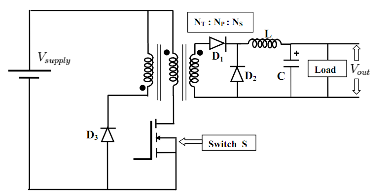

Just that the diagram you linked to seems rather simple, but it is complicated to figure out.
The caption is clear that this is a reduced schematic, but it has the three main elements - a switch transistor (driven by PWM circuit, voltage regulation feedback from the output, etc.), a way to reset the transformer core (the upside down winding and D3), and the output circuit. Feedback and PWM are common to many switching topologies, and are left out for clarity.
In a forward converter, the transformer primary winding and core are charged up through Q1 (the main switch) on what we'll call the first half-cycle of the driving waveform. During this time, the voltage polarity of the primary and the secondary are the same (as indicated by the dots), and secondary current flows through D1, L, and the load. When Q1 turns off for the second half-cycle, the primary winding field collapses, and the voltage across the primary reverses. This means the voltage across the secondary reverses, reverse-biasing D1, so the secondary no longer has a current path and energy in the core cannot go out through the load. That magnetic charge has to go somewhere before the switch turns on again or the core will build up residual charge with each cycle until it saturates. This is what the third winding and D1 fix. When the primary reverses, this drives the dotted end of the third winding down below what we'll call GND (the source end of Q1), turning on D3 and conducting current through the winding, discharging the core. There are other ways to "reset the core", but the third winding technique is very common, especially for higher-power designs.
During the second half cycle, D1 is reverse-biased. When it turns off, the field in L collapses, reversing the voltage across it. This forward-biases D2, so the energy stored in L is delivered to the load. This is why a forward converter is preferred over a flyback design for higher powers - the output inductor is "on" for both half-cycles, first charging up and passing current to the load, then discharging into the load. Compared to a flyback circuit of the same output power, the forward circuit output inductor, rectifiers, and output filter capacitors can be smaller because the peak current is not as much greater than the average current.
