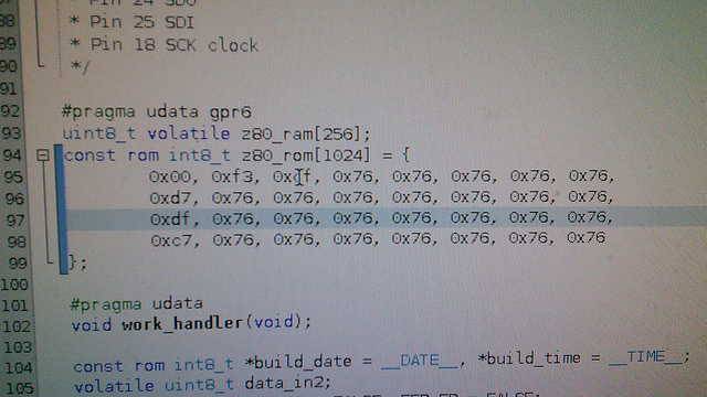

C software: https://github.com/nsaspook/z80memio.git
Z80 test program loop in an array from the C code. Start at PC address 0, NOP, DINT, RST 8, -> RST 16, -> RST 24, -> RST 0.
The other opcodes are HALT to test for PIC emulation addressing errors.

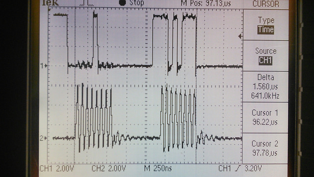

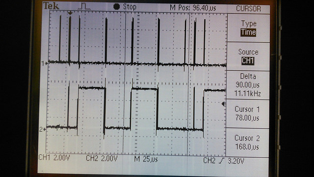

Opcode memory accesses and delays from the RST instructions from the PIC SPI debug view port.
Top trace is the SPI clock, bottom trace is the SDO signal with the NOP (all zeros) access as the first
signal burst. The long delays between RST opcodes is caused by unneeded Z80 DRAM refresh requests
being processed by the PIC.
SPI debug detail with the Z80 running the loop program: 8 bit address 0x08, 8 bit opcode data 0xd7.

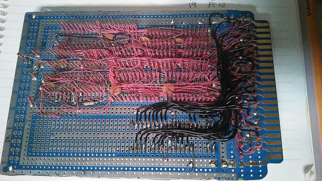

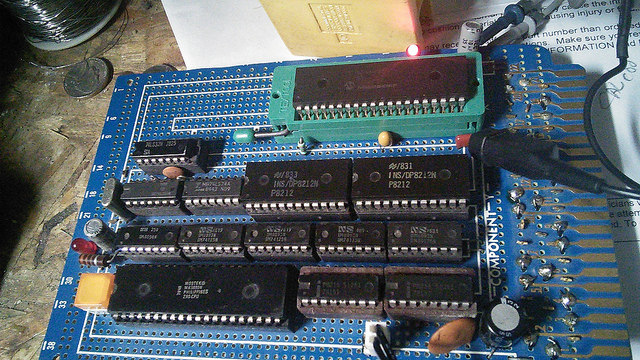

I had no 40 pin wire-wrap socket in the junk bin so I just soldered it.
It's alive. Z80 date code from 1978.

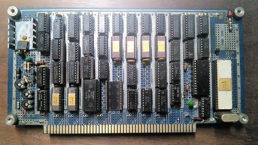

Part of the 'fun' was doing something a little strange with a chip made in 1978 (I think it's a 2.5MHz part that I over-clocked to 2.6) on a board I vaguely remember building as one module for a video processor. Most of the chips on the board are tri-state bus drivers, the Z80 reduced the needed glue to only a few TTL gates.
Now my 'Wall Hanger' S100 graphics controller could have used a lot of modern programmable logic instead of discrete TTL.
