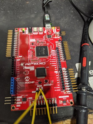

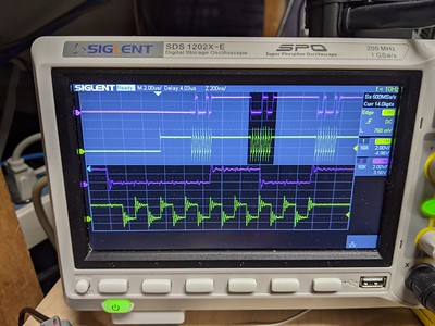

A quick rewrite of imu_SPIreadBytes and imu_SPIwriteByte to something that compiles and should work for a PIC32.
C:
* PIC32: changed to use hardware SPI module and plib_gpio pin functions
void imu_SPIreadBytes(unsigned char csPin, unsigned char subAddress, unsigned char *dest, unsigned char count)
    int i;
    // To indicate a read, set bit 0 (msb) of first byte to 1
    unsigned char rAddress = 0x80 | (subAddress & 0x3F);
    // Mag SPI port is different. If we're reading multiple bytes,
    // set bit 1 to 1. The remaining six bytes are the address to be read
    if ((csPin == __pinM) && count > 1) rAddress |= 0x40;
    //  low(csPin);
    if (csPin == __pinM)
        csPin_m_Clear();
    else
        csPin_ag_Clear();
    //  shift_out(__pinSDIO, __pinSCL, MSBFIRST, 8, rAddress);
    SPI2_Write(&rAddress, 1);
    for (i = 0; i < count; i++) {
        //    dest[i] = shift_in(__pinSDIO, __pinSCL, MSBPRE, 8);
        SPI2_Read(&dest[i], 1);
    // high(csPin);
        csPin_m_Set();
    else
        csPin_ag_Set();
void imu_SPIwriteByte(unsigned char csPin, unsigned char subAddress, unsigned char data)
    uint8_t tmp = subAddress & 0x3F;
    //  low(csPin);
        csPin_m_Clear();
    else
        csPin_ag_Clear();
    //  shift_out(__pinSDIO, __pinSCL, MSBFIRST, 8, subAddress & 0x3F);
    SPI2_Write(&tmp, 1);
    //  shift_out(__pinSDIO, __pinSCL, MSBFIRST, 8, data);
    SPI2_Write(&data, 1);
    //  high(csPin);
        csPin_m_Set();
    else
        csPin_ag_Set();
I don't have the IMU module installed but the MOSI output looks like we have data going out during the IMU init function. The modules uses 3-wire SPI bidirectional data line so a resistor will be needed on

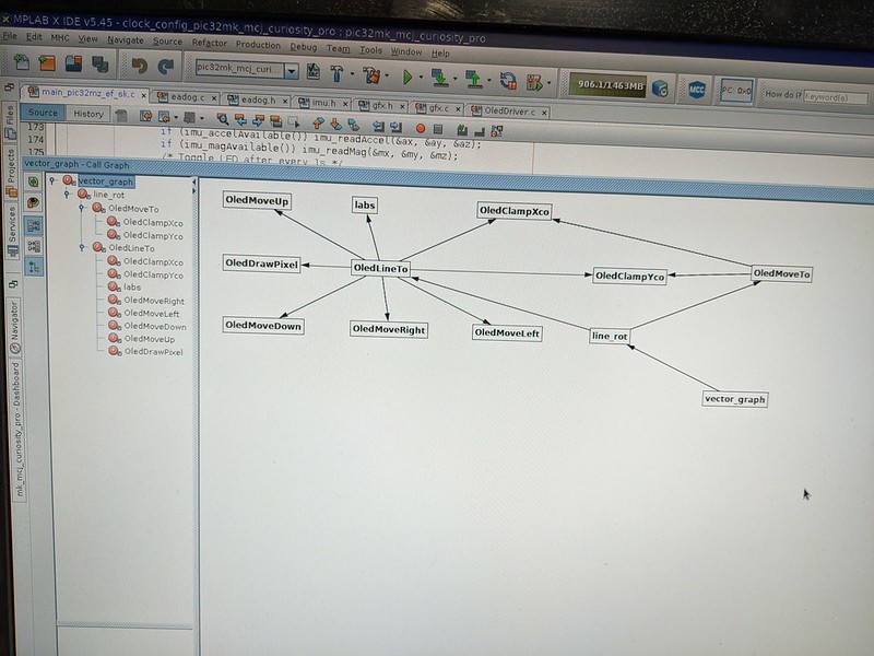

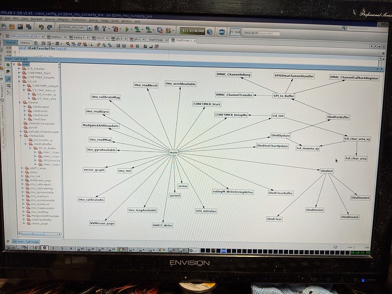

Some downloaded code I'm using for a 3-d tracker using the Parallax LSM9DS1 9-axis IMU Module.
It converts the 9-axis result into a four-dimensional complex number called a quaternion in these variables: volatile float q0 = 1.0f, q1 = 0.0f, q2 = 0.0f, q3 = 0.0f; // quaternion of sensor frame relative to auxiliary frame
https://stanford.edu/class/ee267/lectures/lecture10.pdf

Another thing for those that like pretty pictures of their programming ideas. Most modern IDE's will generate call graphs from program code.
Ah yes and again thank you nsaspook, I now recall seeing but delaying comprehending that facility in, I think, MPLAB. I'll touch on its context in a post soon.
