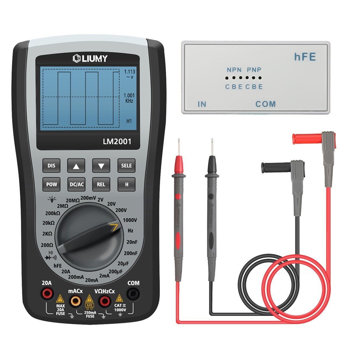

Something like this would probably be more than adequate for looking at the output voltage from an alternator:-
https://www.ebay.co.uk/itm/Handheld...371971?hash=item58f6b7f103:g:YEIAAOSwqrZa4PRI
But I can highly recommend this model which I use in my work – besides the scope function, it can also operate as a multimeter.
https://www.ebay.co.uk/itm/Siglent-...216600?hash=item1a4fa2c358:g:pR8AAOSwYf9bAr0h
