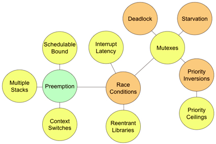

Sure it's possible to write a blink led program using the RTOS multi-threaded style of programming instead of a bare metal state machine on a controller.
Why are you interested in writing applications for them?
Once you go to a multi-threaded approach, things can become more complex until you wrap your head around the issues but you won't see these problems with a blink led program.
https://barrgroup.com/Embedded-Systems/How-To/Preemption-Perils
