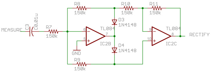

Adjusting this schematic to remove the two 9v batteries.

For the purpose of intended application, it would be better to look at an envelope detector, i.e. a precision rectifier followed by a low pass filter.

Here is a circuit for a precision rectifier.
Instead of the TL084, use a single supply opamp. You will need to create a signal common at half the supply voltage.
On second thought, since you only need the amplitude envelope, you can scrap the precision rectifier idea and use a half wave rectifier.
Half wave rectifier
Thanks for the reply. I assume this circuit will not clamp the voltage between 0-5, will it?

A peak detector or precision rectifier has the same problem. Only a rail-to-rail opamp can output voltages over the entire range of its supply voltage.
You need an opamp like the one I recommended for any of the circuits.
Bob
I'm not sure I quite get you. What is the 'same problem'?
