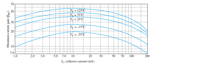

The gain of a BJT is proportional to temperature (below) so, at low temperatures, the op amp input bias current (which is the input transistor base current) will tend to increase significantly, which may cause your problem.

I face this problem only when the ambient temperature lower than -20C.
When the temperature drops, the leakage of Schottky's diodes decreases. And at some temperature, these leaks become smaller than the escaping, input current of the operating amplifier. Also, when the temperature drops, the input current of the operating amplifier increases (the transistor gain decreases). This increases the voltage at the input. Look at my drawings and the voltages in the circuit nodes (at the direct input of the operating amplifier). Don't you see that an additional resistor solves the problem?

Hi,
Thanks for solution.
I used LMC6064aimx / nopb instead of lm324 and problem solved.
According to datasheet LMC6064 has ultra Low Input Bias Current: 10 fA.
