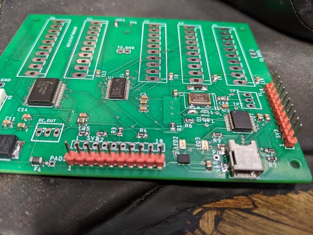

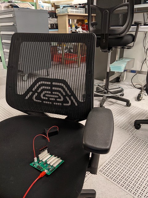

I used this test USB to SPI board for a simple drop test data log from the top of the back of a chair to the seat.
The tiny chip between the pin header and the USB socket is a BMX160 IMU.
https://www.bosch-sensortec.com/media/boschsensortec/downloads/datasheets/bst-bmx160-ds0001.pdf

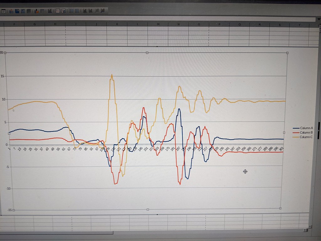

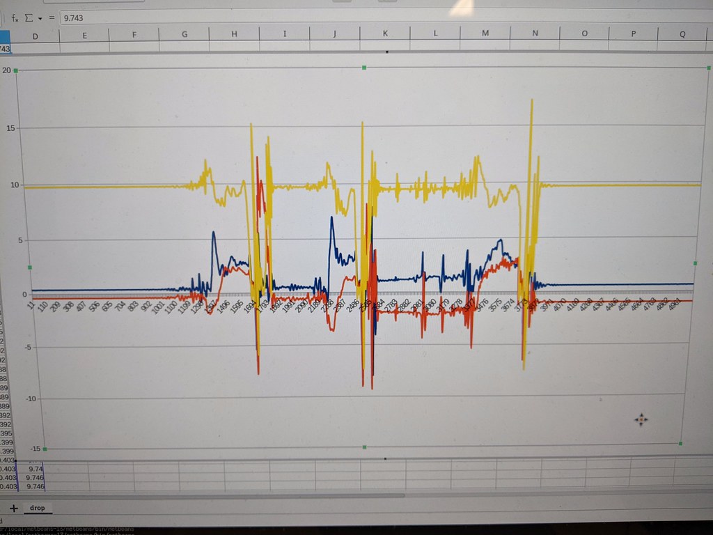

Three drops with only the accel vector logged to a CSV file using the MCP2210 USB driver on Linux. https://forum.allaboutcircuits.com/...2210-on-linux-with-libusb.179080/post-1693734

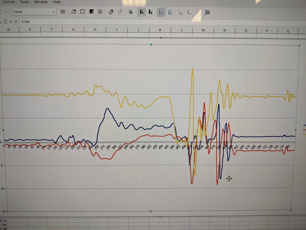

Converted to graph using libre office in Linux.
The middle drop expanded detail.
The yellow line is the Z axis. You can easily see the pull of gravity and handling movement, release acceleration, free-fall (Z goes to zero) when dropped and the impact from just a couple of feet drop to the seat of the chair.

super work man, thanks for pulling the graphs out
I am looking at the zoomed in drop and just want to see if I understand this correctly
on the grapgh the zorizontal is the timelapse and vertical is the g-pull
then
1-55 probe was static (1 g pull)
55-73 probe was handled upwards
73-103 probe was held in the air
103-115 probe was dropped and was accelerating to approx. 1.5g
115-127 was this the impact moment when probe even bounces back from the chair ??

Data point update every ~6ms.
1-55 1G -> falling at 9.8m/s
https://www.phidgets.com/docs/Accelerometer_Primer#:~:text=On the earth's surface an,sensor in a particular direction.
Accelerometers measure acceleration. As such, you might expect an accelerometer to measure the acceleration of the sensor relative to the space around it, and that if the sensor is standing still it should read 0g. This is not entirely accurate. On the earth’s surface an accelerometer that’s not moving will register a reading of 1G (9.81m/s), straight upwards. So what’s going on here? Accelerometers work by measuring the movements of small internal structures caused by accelerating the sensor in a particular direction. When an accelerometer is stationary on earth’s surface, the sensing part of the accelerometer (as with everything else) wants to fall at 1G towards the centre of the earth. However, it is being held up by the casing of the accelerometer by an equivalent 1G in the other direction. Thus, the equivalent measured acceleration is 1G away from the ground. The only time an accelerometer will register 0G in all directions is if it is in freefall in a vacuum.
55-73 was the release and drop acceleration.
73-103 was free-fall post drop acceleration to zero G reading.
https://physics.stackexchange.com/q...lerometer-shows-zero-force-while-in-free-fall
103-115 was the impact with the chair seat
115 - impact decay (bounce)
