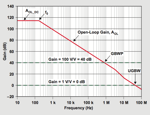

Grinding thru equations you will find the following -
1) At DC the OpAmp G, Aol, will force node at Vinv to equal Vninv of the OpAmp,
so I thru Rbias ~=0. This is commonly referred to as virtual ground or short. Also
referred to as 'servo" behavior of differential amplifiers with high G, the concept of
an amplifier that drives a node to a final value.
Vinv = Inverting input of OpAmp
Vninv = Non-Inverting input of OpAmp
https://www.allaboutcircuits.com/te...tanding-the-virtual-short-in-op-amp-circuits/
2) The OpAmp G, starting at Aol, is a complex gain, dropping as freq increases. This causes
increasing Zout, falling Zin, and (Vninv - Vinv) to rise of network, eg. we lose the virtual short or
ground behavior as our OpAmp runs out of "gas", gain. Also our OpAmp Zout starts looking
inductive, in fact an analysis will allow you to actually compute the L equivalent value. As an
aside when you do that analysis you use PFE on the resulting expression to get at the lumped
element values.
Most OpAmps exhibit either 1 or two pole roll off depending on design purpose. The Two pole
more representative of "fast" OpAmps.
Above you see OpAmp starts out at DC with G = Aol, and then at first pole starts to drop.
This is due to C and gm effects in the OpAmp signal path, dominated by the compensation
scheme used in the OpAmp.
3) The s plane model for a single pole V generator, the G element inside OpAmp, is -
https://inst.eecs.berkeley.edu/~ee1...re05-Non-ideal Op Amps (Finite Bandwidth).pdf
Lots of fun analyzing these circuits. A bit of advice, learn signal flow graph analysis to do this
as it gives visual insight into node and path behavior in the circuits. And saves bucket loads of
time getting at T(s)....
Regards, Dana.
